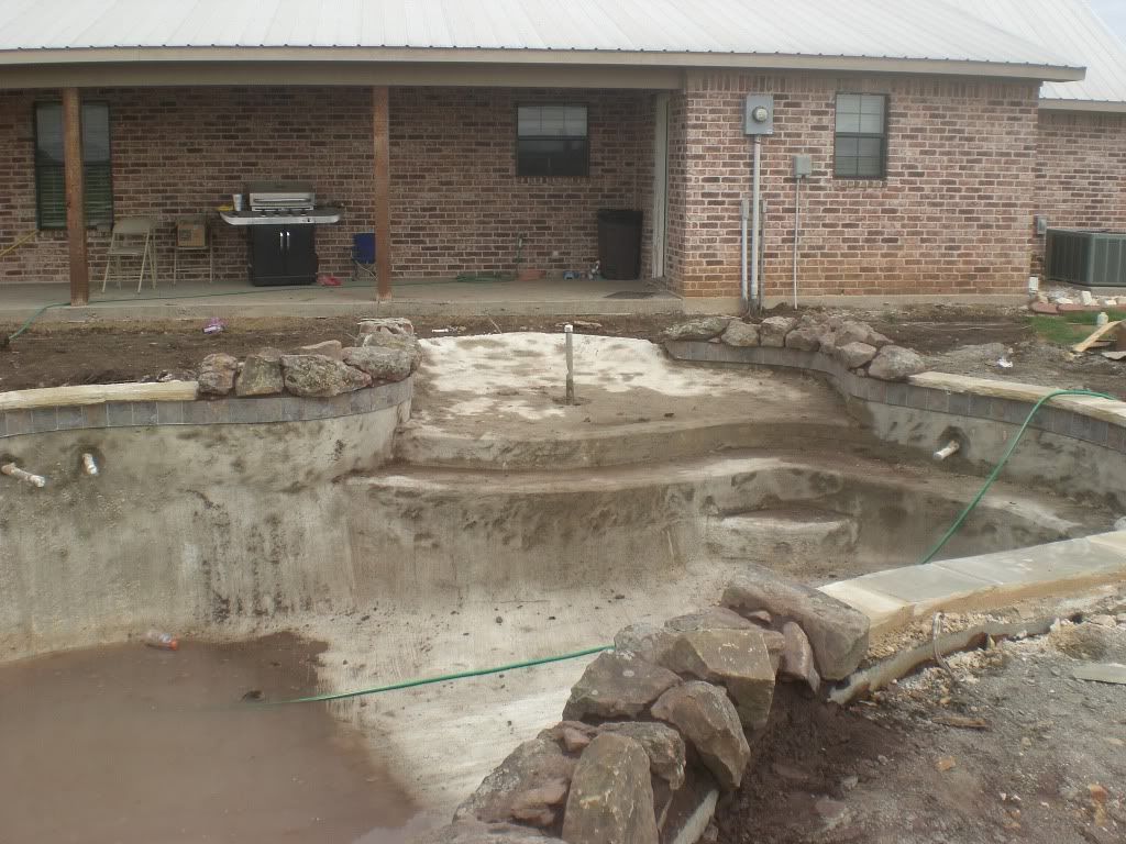

New Update: I went back to school this week (Im an assistant principal) so I havent been around as much. Things have been slow this week due to the weather but all the equipment is now set(sorry no pics of that Ill get some tomorrow) electric is done and finished tile and coping today. Tommorrow they are gonna form up the decks, weather permitting. Ill keep you updated. Here are a few new pics. Tell me what you think of the rocks(moss rock boulders), I am kinda unsure that I like them but I think they look good in our surroundings with and when everything else comes together I think Ill be happy, I hope so!!
spa
beach entry
boulder wall (this is what I call it) There will be a flower bed behind this
I didnt get a very big pic of the whole pool but the rest of the coping is okla flagstone. this is the best pic of the whole thing i took, again ill take more tommorrow :)

I love the jacuzzi. I had rocks around my last pool and they got on my nerves :)
RE: New Pool Build in North TX
i really like the spa veneer and spillway. oh and i like that tile ;-)
Looks great! Love the beach entry, I understand people's concerns but I just wanted it darn it. :) I'm in N. TX also. We got plaster today so I have no idea what I'm in for as for bird poop, but I'm so glad we did the beach entry. :) I love your spill way. Oooooooooh the things I'd do differently. Wish I had that spillway! Your tile and stone looks great. We didn't even consider boulders, wish I had! You got a heck of a deal, my price for a smaller pool, much less decking, with no slide came it at 45k. Granted, that did include a 4k 80' retaining wall on the side of the house that we'll never see, but still, you got a GOOD price. I'm jealous! Can't wait to see your progress. Blue Granite PS is one of my favorites from pics I've seen here. Our PB does stonescapes (bummer......) and I went out on a LIMB and did mauve, Ahhhhhh, the horror! :):):) I think blue granite would be a wonderful choice.
Looks great to me. We are in the same exact stage of our builds. They are supposed to stake out and form our deck today, pour early next week and plaster late next week. We had a ton of rain last night so not sure they can do anything today. The good news is the rain is gone fo a while so next week should be great.
Looks great! I love all of the rock work and how it fits in with the landscape! (I miss that part of the world...)The tile looks familiar -- good choice! We have the pebble tec crew here this a.m., so we are just ahead of you. Keep the pics coming and know that you have an amazing pool! :-)
