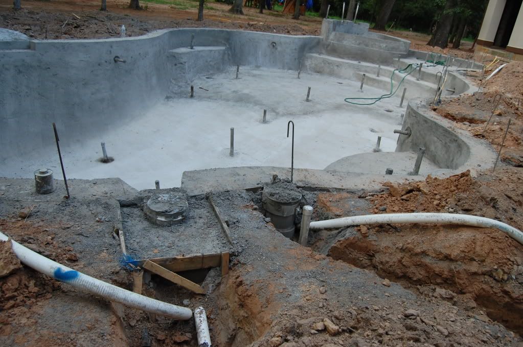

They dug the trenches and should be putting the long plumbing in any day now.

Thanks all for the comments. Not much has happened in the past 2 weeks because of rain :(
The trenches are dug, once the rain stops they need to drain the trenches and long plumb. Tile and coping and rock waterfall will be next (if I can decide on a tile)!

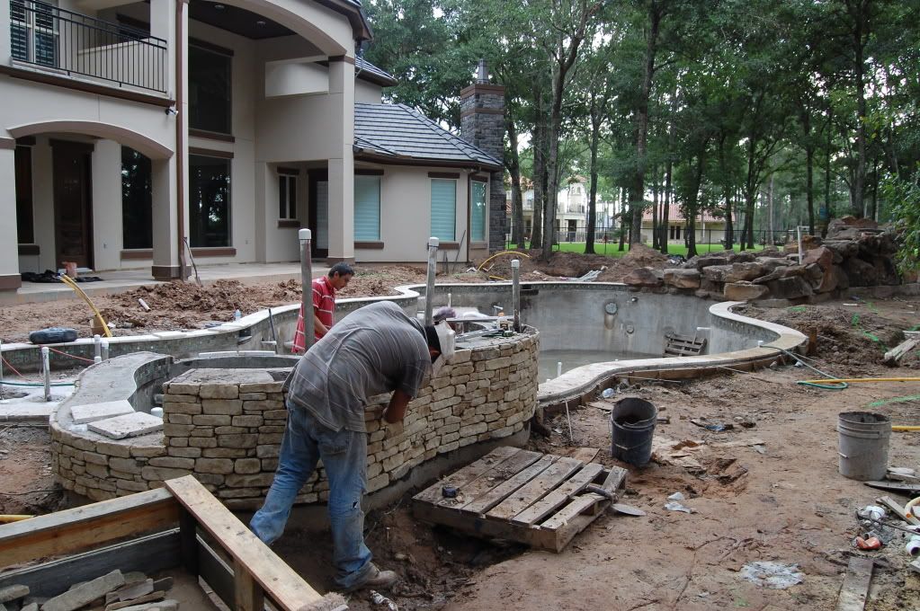

After many rain delays, we have the tile and coping on and they're working on the waterfall.
And this is the stone I'd like to put around the spa and on the raised wall:

Here is a picture of the completed waterfall:
Here is the spa:
