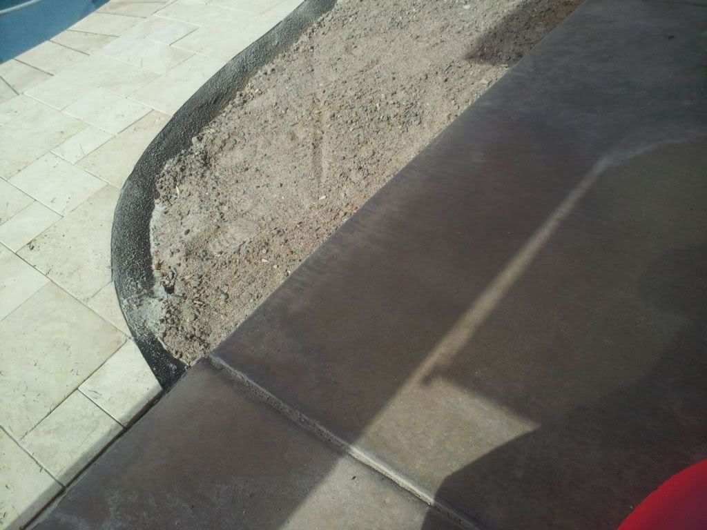

Wanted to post the latest back on this thread and show some pics of how are pool builder addressed our issue with the border. This is 5x the border that we had before - hopefully this will keep everything in place. Very happy with the way this came out.
