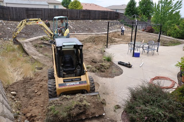

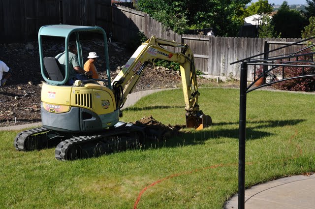

Here are some pictures from the first day of the dig. Should finish tomorrow.
First dig!

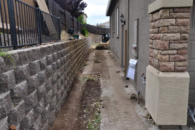

Bad access.

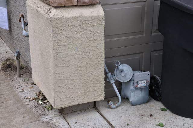

Had to take the gas meter off.

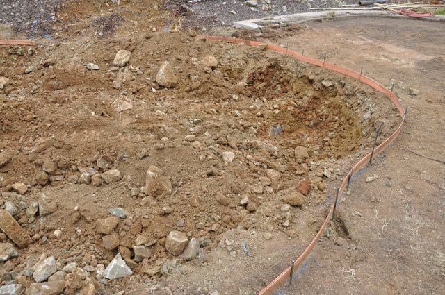

Taking out some of the concrete pathway.
Lots of rock but nothing too big yet.

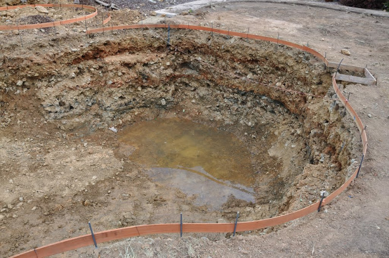

Wasn't expecting water.

    Oh boy. Get a plan of action before proceeding. That doesn't look deep either. Hopefully, it's just a pocket or it's source is traceable and correctable. We've seen what water can do before.
    Scott
  • mudn
    13 years ago
    Water is at about 3 feet. This is in the shallow end of the pool on the side of my yard that is closest to lots that are higher up the slope. The deep end which is dug out deeper than 3 feet has no water. PB believes it's sprinkler excess. He's going to over-dig a bit and put some gravel on the bottom. The pool will also have hydro-static valves. Anything else that should be done?
  • poolguynj
    13 years ago
    IF the water doesn't sbside, I would suggest a bedding the entire pool with a layer of gravel and a dry well be installed. This way, you can pump the water from under the shell when the time comes to empty it for services like new plaster, tile, coping, acid washing, etc...

    The water continues to leach through the soil and is traveling from the shallow end and pooling in the deep end. So basically the entire bottom surface is a muddy mess. Doesn't look like it's going to stop any time soon though after our very wet winter it may subside as we enter the dry season. I find it hard to believe the water is due to sprinkler excess.
    The suggestion of a dry well is a good one. I know the gravel is going to be going in.

    Here are a few pics. This one shows the water in the shallow end and pooling in the deep end.
    Interesting layers. These lots were terraced by the home builder so a lot of this is just fill.

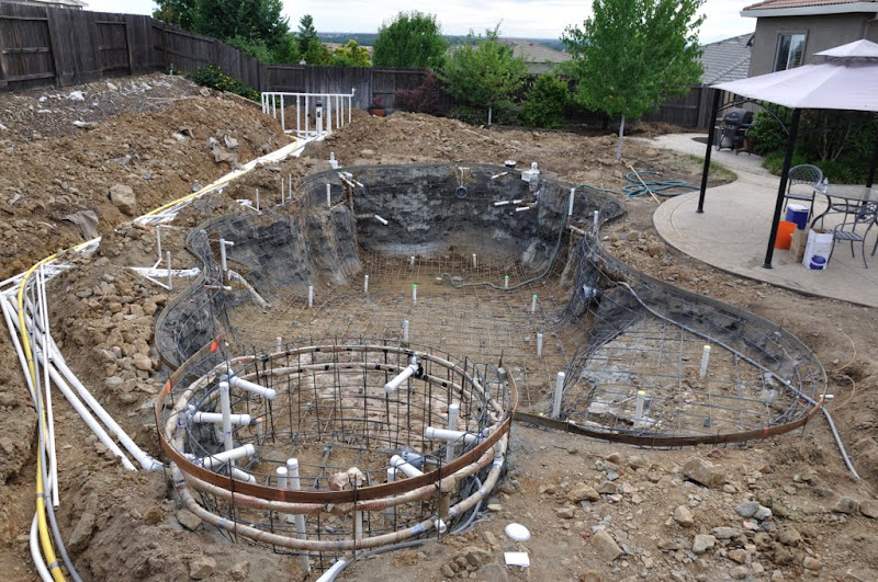

    Rough plumbing has been ongoing the last 2 days. They still have to finish the spa and water features after rebar gets done tomorrow.
    Skimmer and auto-fill:
    Equipment pad:
    Paramount PV3 in-floor debris canister:
    Lots of PVC:

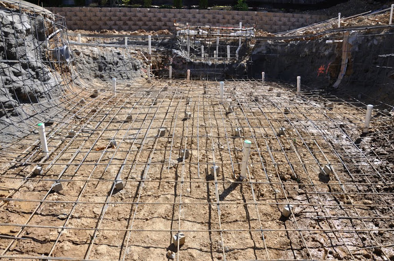

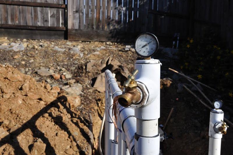

    Few more pictures of completed rough plumbing and rebar. Inspection today and gunite tomorrow if we're lucky.

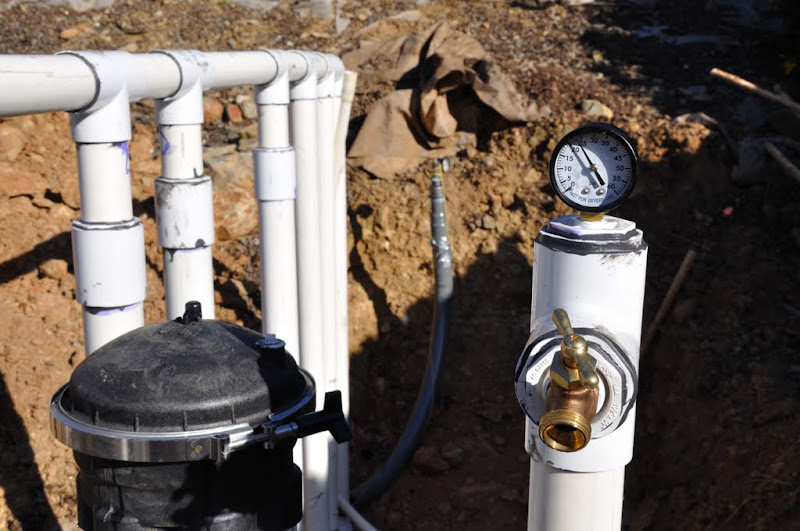

    Is it just me or could they have done a better job here by digging a wider trench?
    My eagle eye spies a leak beneath the ring on the 6 port valve... pressure dropped from 24 you see here to 16 this morning. Ring actually was leaking in 2 different spots.

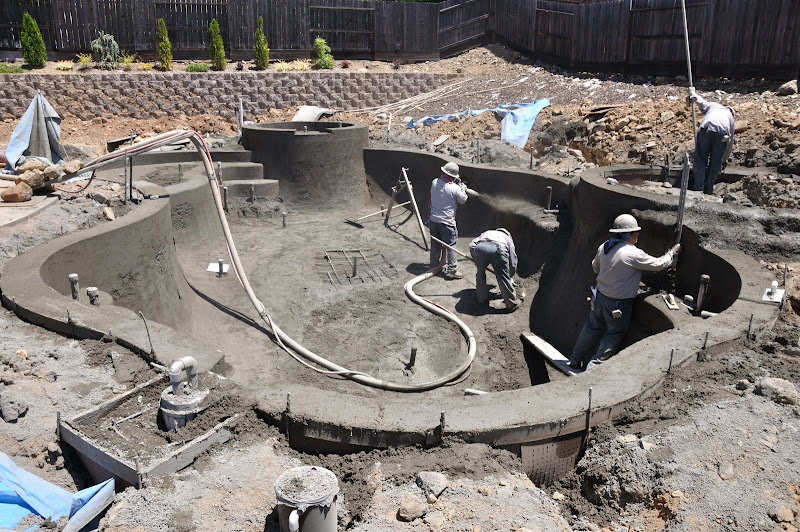

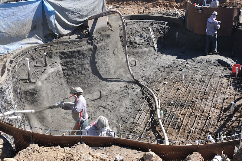

    Gunite is complete! Yea!

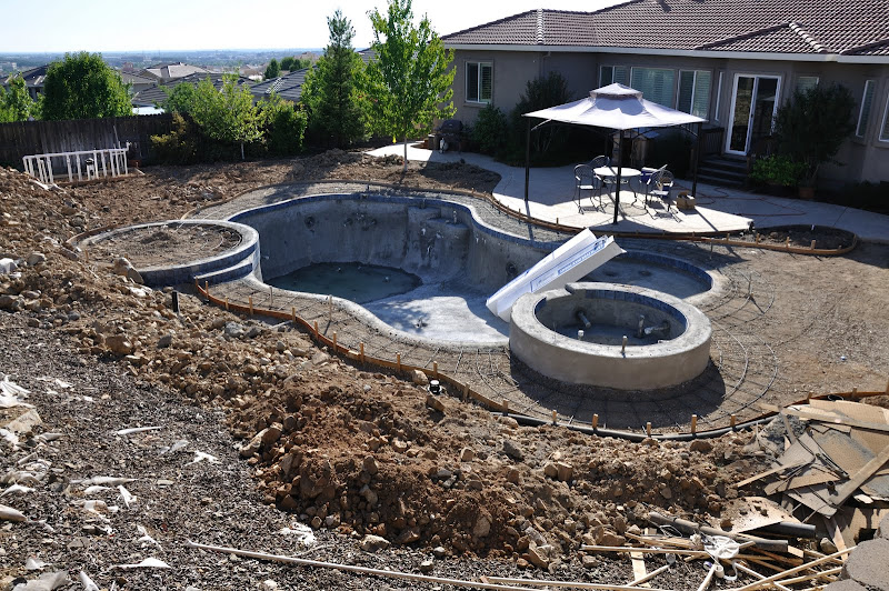

    Overview of the deck layout.

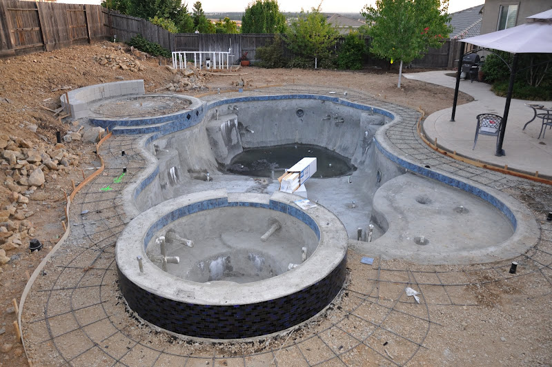

    Here's a few pictures of the decking:
