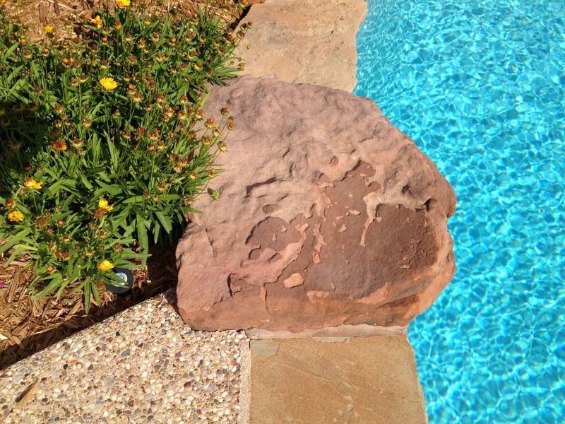

Here are some pics of our Oklahoma flagstone. We will be powerwashing it this weekend, cleaning and scraping, and sealing.
When it is wet, is when ours becomes really soft and sandy. Here is a pic where someone gouged the stone by dragging the umbrella that fits in a hole in the decking.
Here are marks made by the Polaris.
Deep end coping erosion caused by hands grasping wet coping.
Close up view
Erosion caused by water runoff
Erosion caused by pool and sprinkler run off
