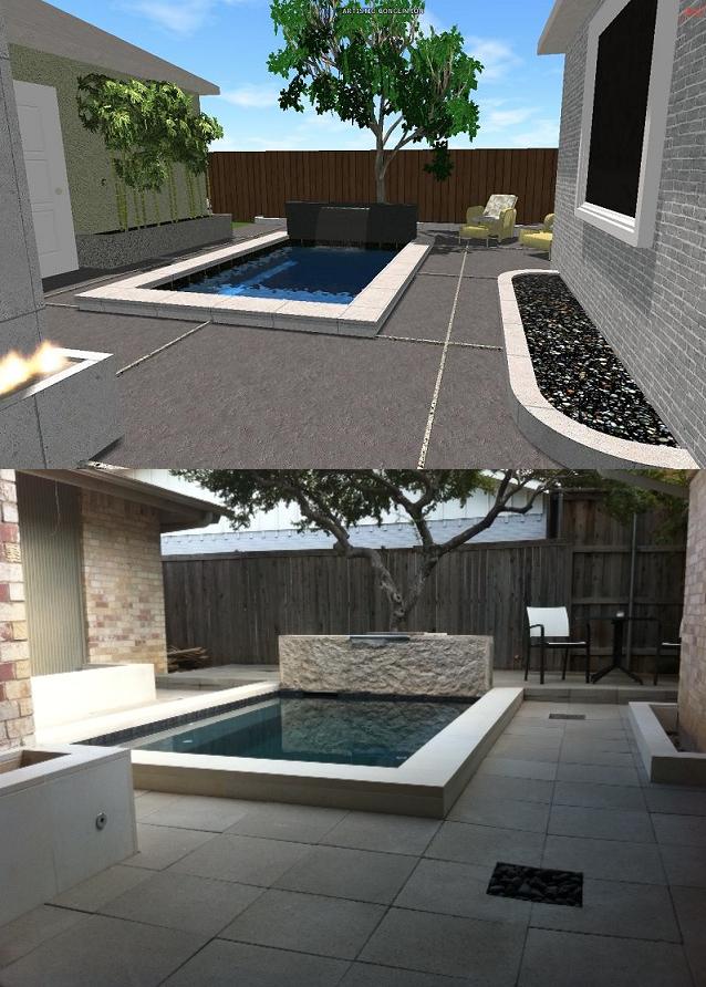

We're building a Los Angeles style modern architecture pool to replace the oversized koi pond that was located in the courtyard of our mid-century modern house. Basically, you walk up to what you assume is the front door to our house, and when you step through it, you aren't in the house yet, but a large courtyard that then leads you to the real front door. Rather than sticking a large pool in the back yard, we wanted a smaller pool (oversized hot tub?) in this courtyard so that it greets us when we come home, and we can see it through the large window in our living room.
Here are the concept drawings:

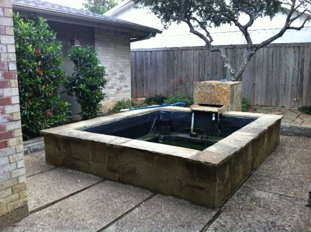

And our "Before" pic with the Koi pond still on place...

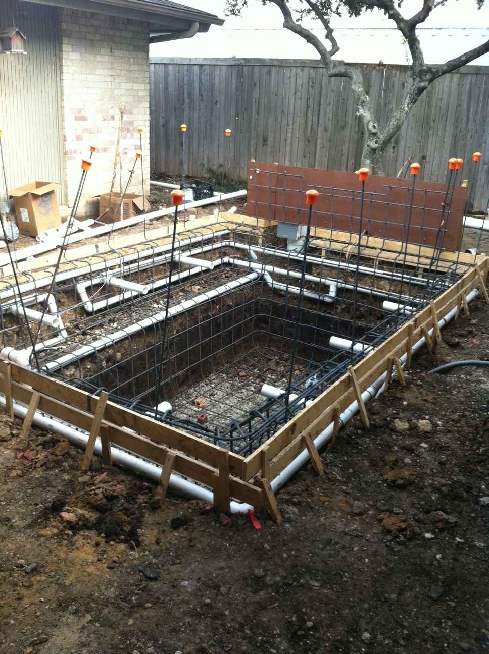

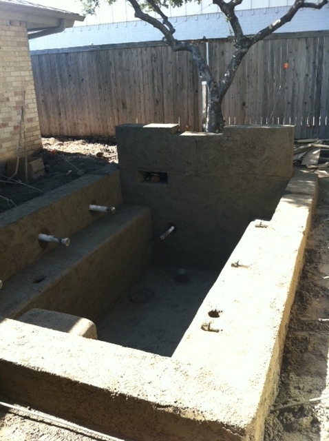

We've already had the dig, plumbing, electrical, and gunite. Now we're in the watering/curing phase, and naturally things have ground to a halt, so I should have plenty of time to waste on here!

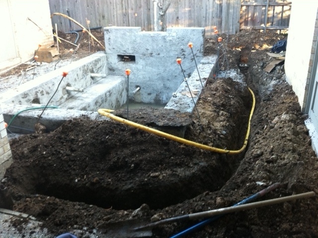

They are continuing to dig up the courtyard, this time to install the gas line for our heater, as well as plumbing a new faucet from the water main in our front yard into the courtyard. Every stretch of grass I own now has a trench in it. Things definitely look worse before they start to look better!

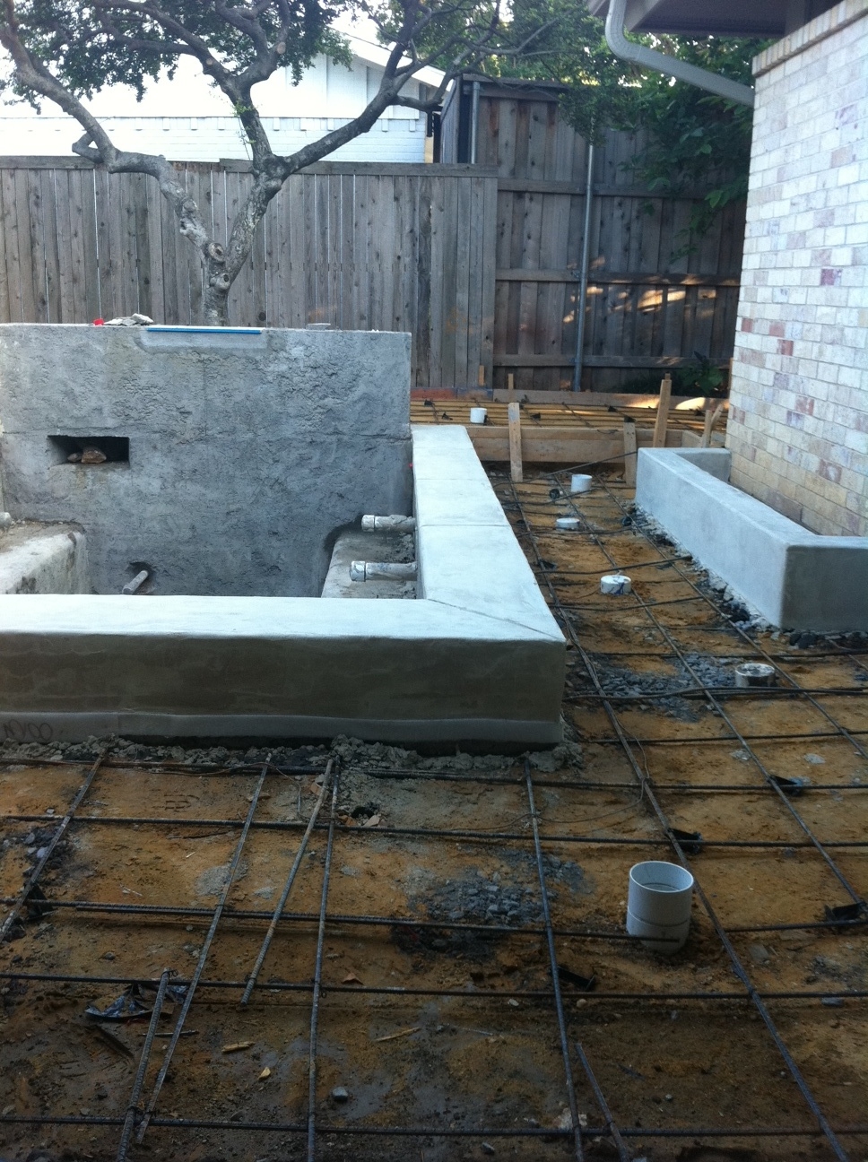

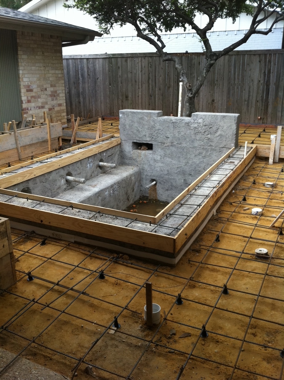

They've finally rebar'd for the decking. Next step, we will pour the planter boxes and coping. At least it no longer looks like a bomb went off!

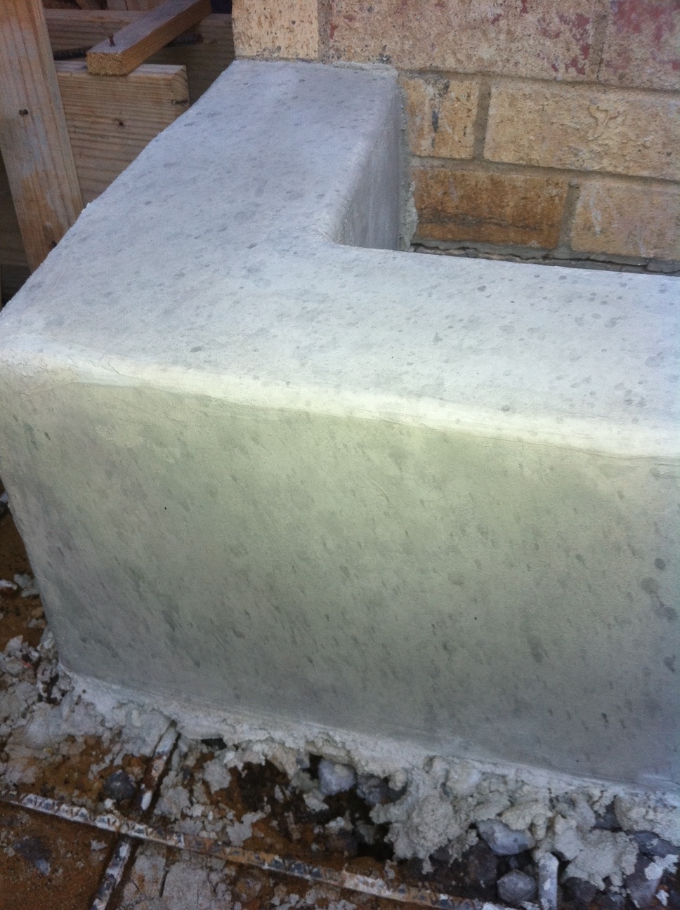

UGH! Well the concrete company came to pour the coping, the planter boxes, and the fire pit. The forms must have been off or something- I don't know what happend, but there's not a single straight, true line anywhere right now. The edges are not sharp and straight like the modern look we're going for. They're bumpy and wavy as if made from Adobe or by 3rd graders who go ahold of some potting clay. The southwest Santa Fe deal is great look, but NOT the look we're going for here at all.
They're coming out to redo it all, which means more delays. A delay due to weather, I can understand. Delays due to incompetence, I can't abide. Seriously peeving me off here.

So glad you are making them redo that concrete. It looks bad in the pictures, I can only imagine what it looks like in person.
so 2 questions:
1-Is it me or is the top of the skimmer throat higher than the bottom of the cantilever of the deck? Some pictures it looks like it others it doesn't. Bummer on the location of the skimmer- an in beam small spa size throat access skimmer would have been ideal in another beam to avoid staring right into it on the feature wall.
2- I see the jets are possibly stubbed out as 2"? What jets are you using?
Also, make sure they pull that trampled down steel up into the middle of the deck when they pour. Im sure they will, but I've seen lazy subs plenty of times that need a little common sense direction. Love the design! keep the pics coming!

Construction has been called to a dead halt.
I've never been so stressed out or depressed about something that's supposed to be a fun addition to my life.
The concrete company has flatout lied to me. On day one, I went to them with pictures of beautiful, straight, architectural concrete from modern patios and pools. They assured me they could do that- and that they could do it with this particular concrete product. TUESDAY, when I was sitting outside, overseeing the redo job on the planter walls, etc- the rep from the concrete company told me that they absolutely CANNOT do straight edges or 90 degree corners with this product. The best they can give me is rounded off, hand-troweled, adobe looking garbage. But somehow, she still considers this "Modern". I wanted to smack her in the head with a copy of Architectural Digest!!! I almost lost my freaking mind!
Look how the planter wall closest to the camera slopes DOWN towards the house:
So now, I have a courtyard full of awful looking rounded corners. There's not a straight line to be found anywhere. Every edge is wavy-as if done by 3rd graders. Every corner looks like the pinched corner of a bit-o-honey bar. Basically, the EXACT opposite of modern design.
My PB asked why we didn't just use cut stone to get the corners I wanted. I told him the truth. That's what we were planning to do before the concrete company sold us on this other material that was supposedly gonna blow our minds. The only thing it has done is disappoint.

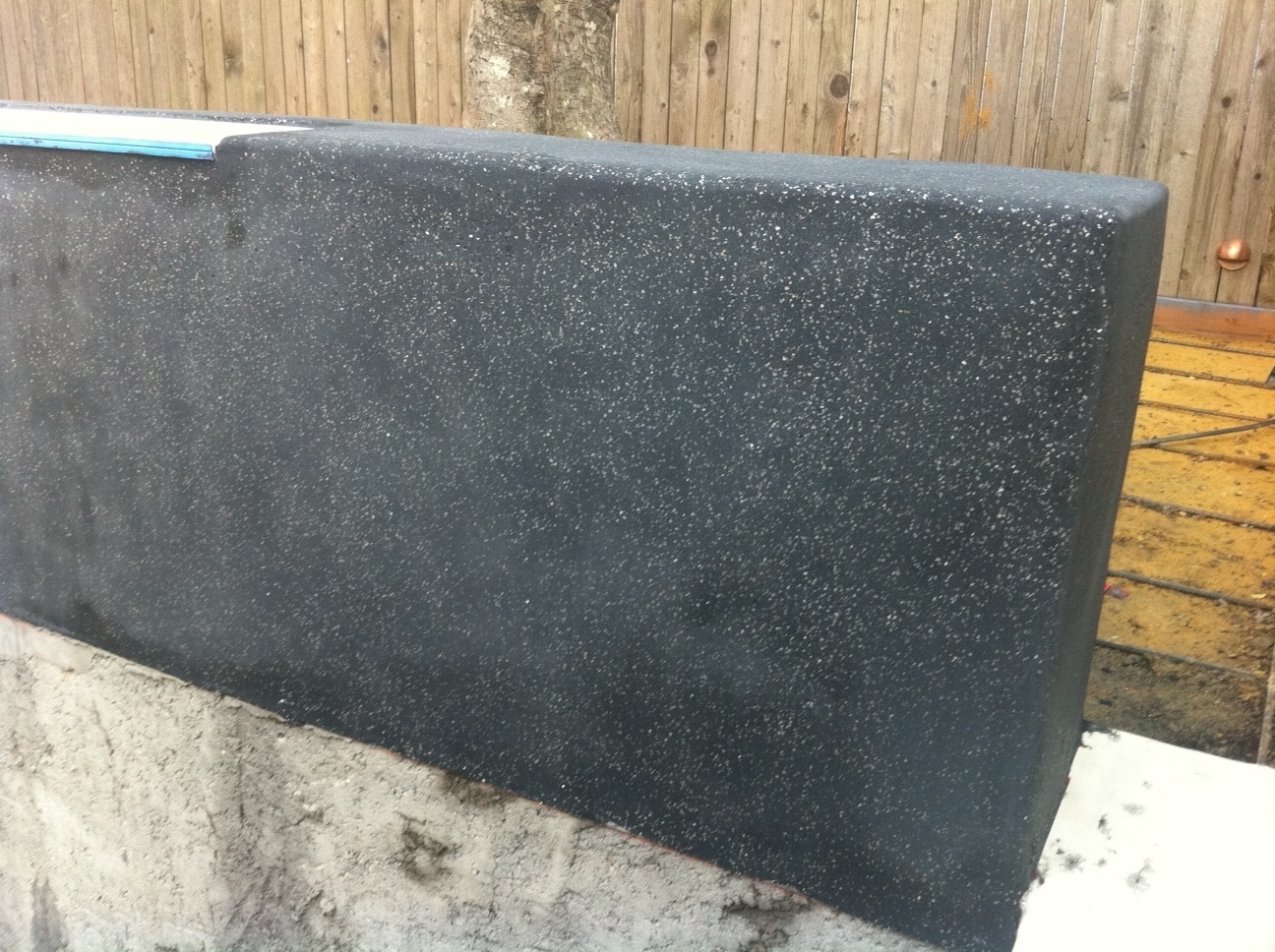

Then, yesterday, the concrete company came back to finish our waterfall wall. We had agreed to cover it in this black material that had all kinds of sparkly mirror pieces in it. The sample looked incredible. The finished result looks like someone needs to clean a dirty chalkboard. It's horrible, and we're going to have to figure out what to do with that horrible looking wall now.
Also, when they were grinding that wall down to expose the little mirror material, they slung black offshoot all over the planter walls that they had come out to redo they day before!!! UNBELIEVABLE!!!!!!!
Basically, this concrete company has lied to us, misled us, and fallen short of every single expectation that was set for us. Every product they have put in my courtyard has been disappointing, and every day I come home from work, I see another new thing they've screwed up.

The PB is sorting it out as we speak. Needless to say, he's p.o.'d because this pool should have been finished by now. We're most likely going to go with a cut stone. We've been to a stone yard, and yes, we were able to find some that will look exactly like what we want, so that's good news. The owner of the pool company is supposedly coming out to look at the mess today. Hopefully after seeing it, he's as angry as we are.
Once we get the go-ahead, they will jack out the existing concrete and replace it with cut stone. Then we can finally get on with this project. And about time too, because it's already HOT here in Dallas. We should be soaking in cool water by now!!

Barb and Larry, Angie and Banana- Thanks for the thoughts. Honestly, this PB is bending over backwards to make everything right, which is why I'm not going to name them on here. I don't believe it's the fault of the PB. It definitely was the concrete company trying out some new products on my dime.
We ARE jacking it all out and starting again. We're going to use cut stone, because at least it has straight edges, and since nobody around here knows how to do that sharp concrete, this will be our best bet. It's not going to look as great as it did in my imagination. Hell, it's not even going to look very much like the original pic in this post! But hopefully, it will be beautiful anyway. The bad news is that we will probably have to custom order the cut stone from the quarry, which will be anywhere from 2-6 weeks. @$!#$^!~@#%~@#%~^

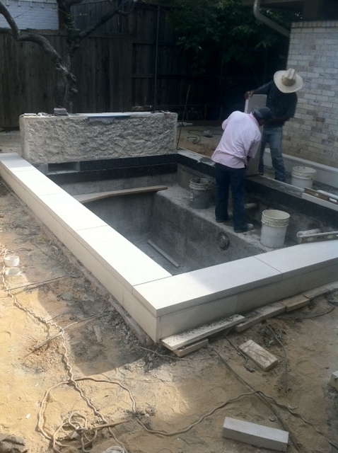

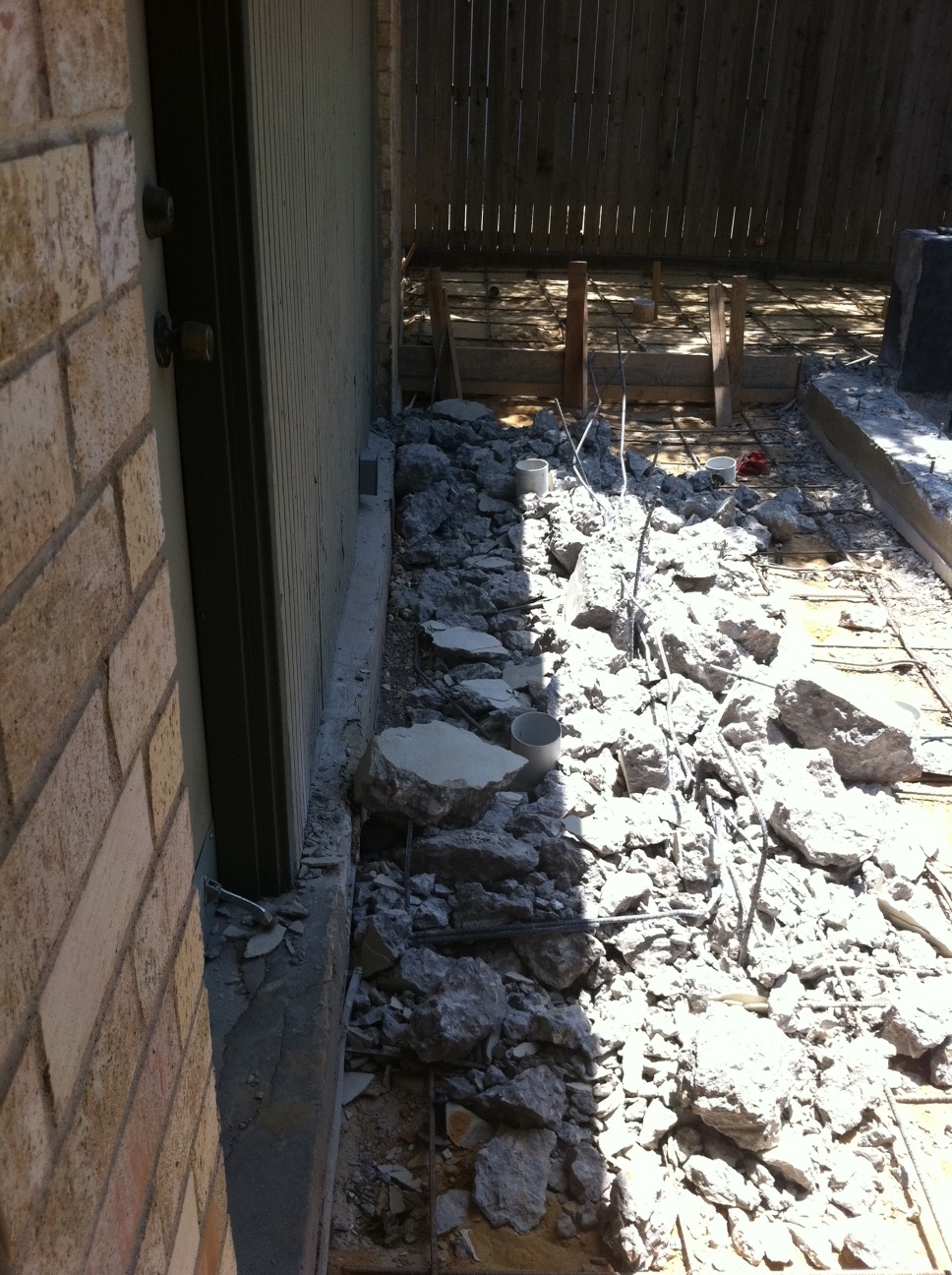

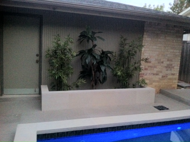

Ok, so step one- the dream team (ahem) came in last week and jackhammered the ugly adobe walls and coping. GONE.

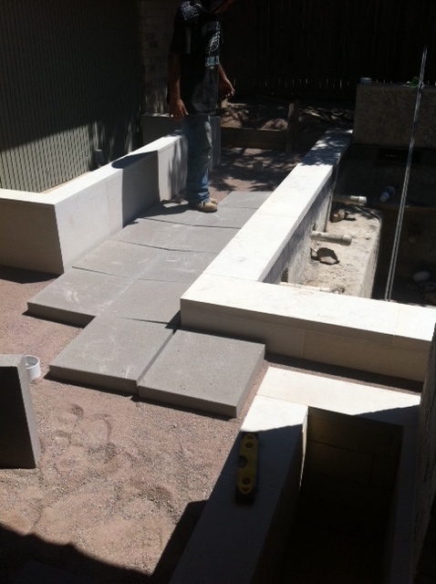

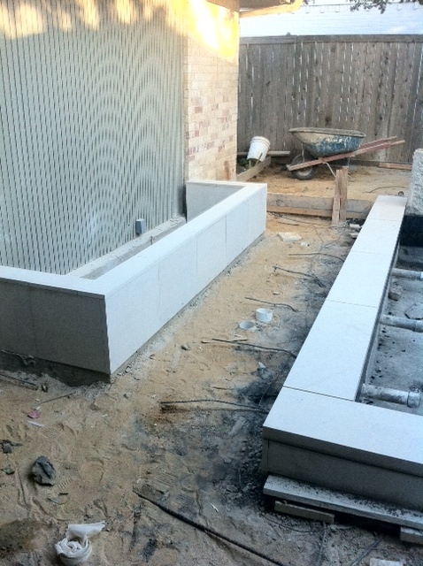

Step 2- For the last 5 days, the stone guys have been putting up the cut stone (Calico) for the planter walls and coping. It's an amazing improvement, and for the first time in a long time, I'm actually kind of excited about this project again. Of course, experience tells me that this just means I'm due for a staggering downfall any minute now...
Just look at those smooth, clean lines!
They were supposed to have this done by Tuesday. Well, it's Wednesday and they're still working on it. No surprise there. As soon as they get this done, the decking can begin. Large gray square concrete pavers. Then the courtyard will start looking livable again.
Sidenote: because they've been cutting this white stone for 5 days in my enclosed courtyard, everything is covered in white dust. Trees, windows, chairs, you name it. As soon as they finish this stone- hopefully today- I will be taking a water hose to the whole area! :)

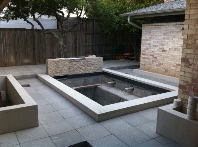

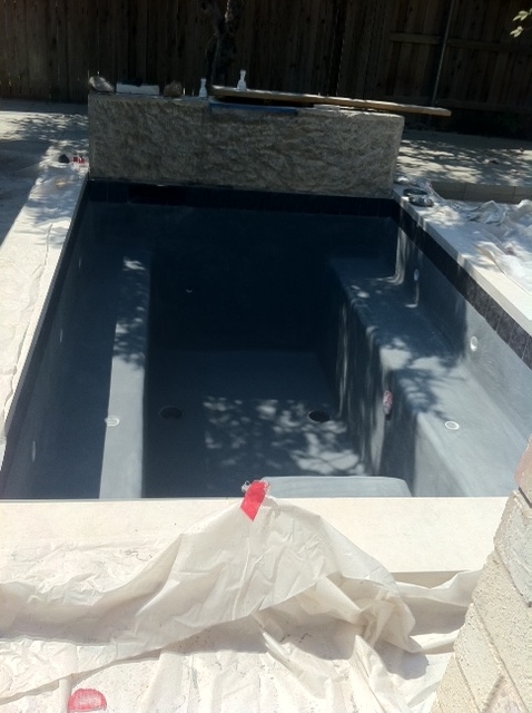

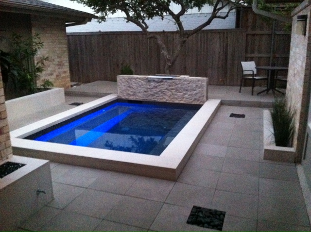

Thanks for all the kind words, everyone. TODAY, the stone mason is supposed to "finish" all the stone work. The sad thing is, there are only like 5 cut stones that need to be placed, and despite that, I doubt he'll finish today. His guys are the slowest on the planet.
Funny story, yesterday the wife and I were having a meeting with the PB at their office. Another customer of theirs came in, looking not-too-happy, and said he needed an update on his pool situation. I thought, "Oh Lord, what did they mess up on this guy's site?" But his question was "What's taking so long with the PERMITS?"
Wow, he's not even past the permit stage yet! Poor b@stard has NO IDEA what he's in for!
Anyway, supposedly we finish the stone today and do the decking next week. The material we chose for our waterfall wall is a black, water-blasted granite. It's freaking gorgeous, but will take 4 weeks for delivery. That puts us well into September, which is unnacceptable. We asked if they could just go ahead and finish off the pool so we could start swimming (the Texas heat is crippling) and then install the granite when it comes in later. He said they could definitely do that. They would either put up some scaffolding so the guys could instal the granite while sitting above the waterline, or they would drain the pool, have them install it, and then fill it back up quickly.
Does this worry anyone? The PB says it won't be a big deal either way. Shouldn't hurt the plaster, etc at all. What do YOU think, Pool Forumers?
RE: New North Dallas Modern
Quick update- the stone mason is FINISHED! It only took him 3 1/2 weeks! Wouldn't have been so bad if only he hadn't promised to have it done in one week. Pool Builders, it's all about setting the correct expectations!
Concrete pavers start tomorrow. Then it will finally look like a patio again, rather than an awful dirt hole with some cut stone placed here and there.

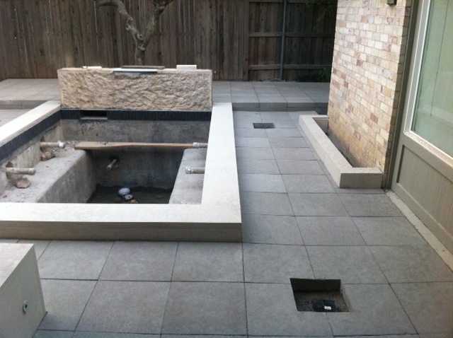

SPOKE TOO SOON! Tuesday morning, the paver guys showed up and said that they'd be finished by Tuesday evening or Weds evening. When I got home from work at 4pm on Tuesday, they had only prepped half of the courtyard, and had apparently taken off early. Sure, why not? You've done half a day's work. It's Miller Time!
It wasn't until I got home from work on Weds that I became furious again. They hadn't even SHOWN UP on Weds. So, to recap, they were supposed to be stone cold finished, and they still hadn't even prepped half of my courtyard. This morning, when it got to be 9am and they STILL hadn't shown up, I called the PB. "Oh, we're having issues getting the pavers delivered to your house." Something about an Excel spreadsheet mixup between the pool company and the paver company. I said, "That doesnt' explain why my courtyard hasn't been touched in two days! Even if you delivered the pavers now, we wouldn't be able to install them, because the courtyard isn't prepped!" To me, that means there is still a full day's work to do before we can even THINK about installing pavers. Or if experience has taught me anything, more like TWELVE days work. Considering how slow these subs all are.
I am freaking FURIOUS. This pathetic, hack pool company and their complete inability to communicate even the most basic of directions with their subs has put me over the edge. The only thing left to do is finish the pavers (or START the pavers) and plaster the pool. IF this were any other pool company I'd say we have about a week's worth of work left. But with these vapid morons, I'd say we're easily looking at another month.

Stewart- I doubt my project will ever be finished OR look great.
The paver boss showed up today, and he's making the work crew start all over completely. All the pavers are being pulled up and reset. First of all, the completely inept crew made tons of mistakes setting them down. You can see in the pic above, the huge "valley" that the pavers make in the middle. The whole courtyard is a complete clusterF once again, and we have lost another week on this project for NO REASON WHATSOEVER other than the fact that the crews NEVER have any supervision. SUPERVISION. It's critical. When you send 3 guys to my house in the morning on day one, and don't even TELL THEM WHY THEY'RE GOING THERE- then your business SUCKS. Period. You are a horrible businessman.
Thankfully my wife speaks fluent spanish, so we're able to tell the guys what their idiot boss SHOULD have told them. But we also have jobs, so we can't be at home every day of the week. Not that being there every day would matter because the crews don't even bother to show up most days.
No amount of enjoyment I can possibly get from this pool will ever be able to make up for the sickening amount of anger and depression that I've had to put up with for the last 4 solid months. I wish we had never started this project.

Ok, they were supposed to come and finish the deck this past Saturday. It was going to be the last day of decking. Then cleanup, and then plastering this week. Those of you in the DFW area know full well that Saturday, for the first time in months, it rained here. Rained and rained and rained! So now we're off schedule again.
The good news is that the decking crew did show up this morning to finish the job. And it's 99% finished anyway. They just need to level some stuff out and fix one or two things. HOPEFULY, they are done with that as of today. I don't count on it, but it would be nice. I've had patio furniture sitting in my living room for months now, and I'd love to get it outside where it belongs!
I hope to be showing you pics by friday. We'll see!

The decking actually got finished. I couldn't even believe it when I walked into the courtyard yesterday. Not only that, it actually looks good. PB still says we are on track to plaster and fill by the end of the week. I truly hope so. Then it's just a matter of the landscaping and lights, and finishing the fire pit.
The empty drain holes will be filled with polished black river rocks...
What really freaks me out is that it's actually starting to look like the original sketch!
It is really looking great. Sorry you had so many obstacles.

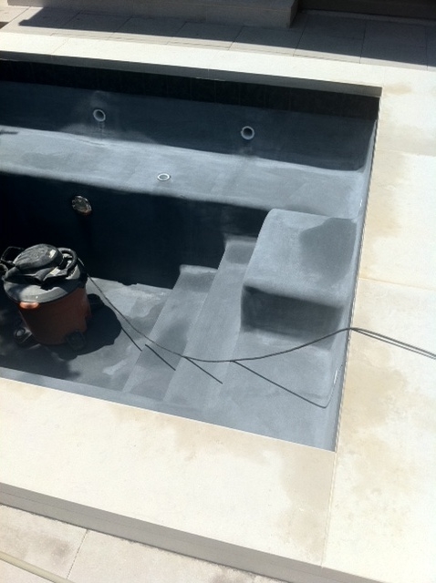

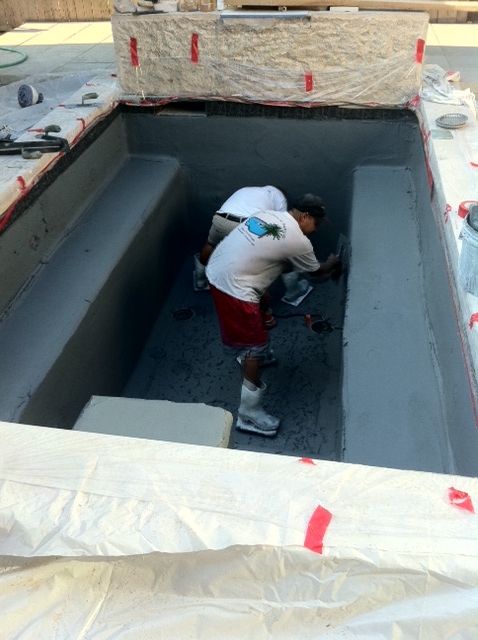

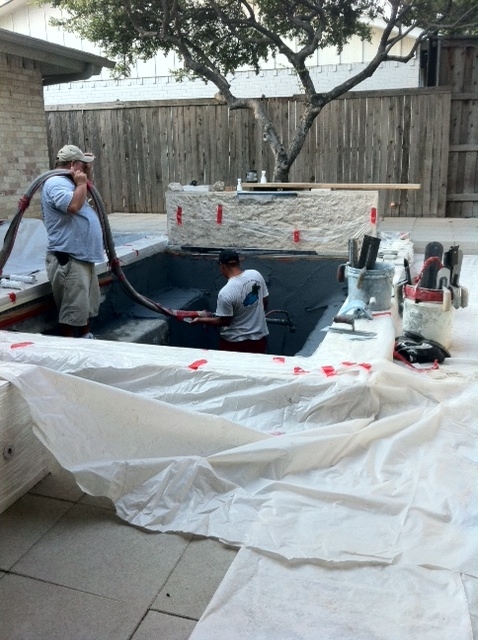

Four months and two days since we started digging, they plastered the mother yesterday. Then, with fresh plaster curing, the pb shows up, turns on the pump, and blows dirt and rocks out of the returns to settle on the bottom. There are already stains, and the plaster isn't even 24 hours old yet! I don't have a vacuum hose or I would have immediately sucked that stuff up. Oh well- hopefully the startup process will take care of some of those dark brown dirt stains. I'm not hopeful, but maybe...
The plaster crew did every single thing the diamondbrite manual and other posters on this and many other forums said repeatedly NOT to do. They did an acid wash of the diamondbrite, which causes tons of streaks in dark colored plaster (the color is Diamondbrite "Steel Blue" which is 3 parts Tahoe Blue and 3 parts Onyx). They left the metal garden hose dangling from the side which puts lots of water pressure on the new plaster. They didn't put a rag or sock around the end of the hose, leaving the metal hose tip in heavy contact with the plaster. Etc and so on. I called him out on every single one of these, and the plaster guy had some reason why our pool was an exception to that rule. Whatever.
So here we are. We have a plastered pool. The black granite for the waterfall wall is still one month away from being delivered, so that's not in place yet, and the plants and landscape lighting haven't been put in place yet, so the project is a good long way from being done. Whatever- my wife and I spent last night floating in a nappy pool full of hose water, just to cool off. Being extremely careful not to touch the plaster!! It was more stressful than relaxing, but at least for once in this awful Texas summer, we weren't sweating outside!
Here is a comparison pic of the original design, and where we're at so far. I'd say we're pretty much on track with the larger design...
Congrats, it looks very classy with clean lines.
Watch you pH. New DB raises the pH quite quickly as it cures. Test it 2x a day for the 1st couple weeks and add acid as needed.
They could add the black stone to the drains and planter now, I suppose. That will further the setting some.
Scott
Our pH is sky high! I keep adding acid slowly, but the pH is still so high its color doesn't even appear on the test kit. It's such a small body of water (2700 gallons), I'm afraid to add too much acid! Yes, I've been using the calculators, but it's still intimidating! The guy sent by the pool company to do our startup is clearly insane. We had the system circulating 24 hours a day, as is recommended, but he scheduled it to only run for 7 hours a day. And this TWO days after the plaster! I killed his schedule and set it back to run 24 hours. Naturally, I'm terrified that we're going to ruin the plaster.
Thanks for the compliment Brentr. We're still a month away from being finished with the project, but at least we can get in and cool off now.
Add a quart at a time, waiting an hour between testings to allow it to do its thing.
What pump do you have? Two speeds and variables should be run slow to avoid aerating the water which drive pH up.
Scott

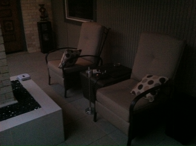

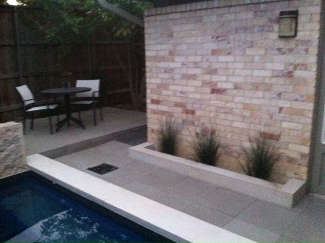

Ok, here are some low-rez pics now that the planters are full. I tried to take these at Dusk to get the pool light in there too. It messed with the pic quality...
In that last pic- You can see black glass in the firepit that wraps around our brick column under the covered portion of the courtyard. They finally let us heat the pool a little- not too much- but enough to make it warm and bearable. This lets us swim despite the chilly evenings. It'll be another couple of weeks before we can do full hottub mode. The only thing left now is the black wasabi granite that will cover the waterfall wall.
