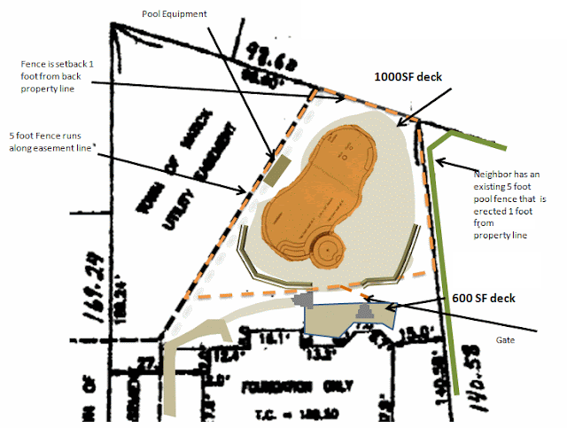

RE: New Pool Drawn Out
| Our pool builder sprayed out the pool yesterday in prep for the build to start on Monday. I traced it over so you can see it better. Will be shifting it back a bit so we can maximize our patio area. Here are a couple of designs.

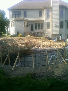

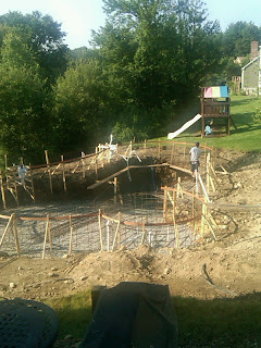

RE: New Pool Build in Boston Area
| The fist week of the build is complete. All the steel with the exception of the stairs is complete. The electrician also came by today to electrically bond the pool. That means you don't supposedly get cooked in the event of lightening or other electrical issues. You'll see the copper bonding in the right photo
