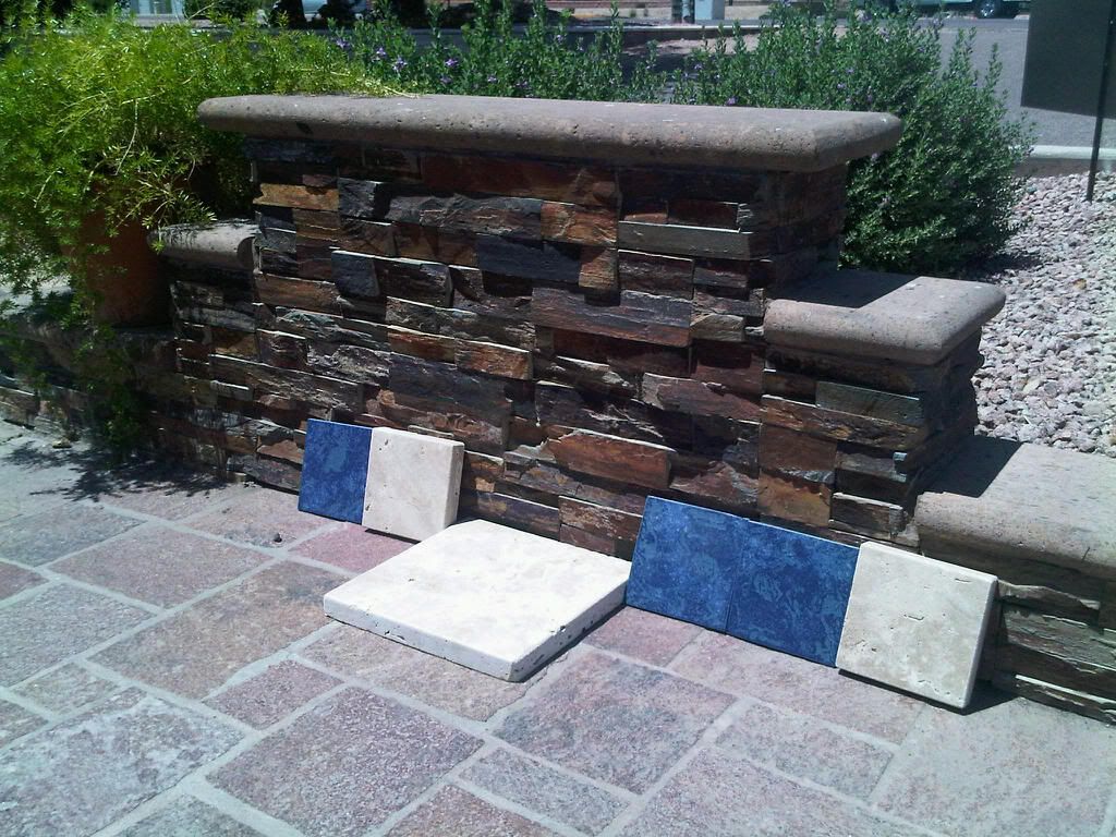

It was interesting that you mentioned you were looking at Crema, we were on the other side looking at the Noche and went somewhere in the middle with the Sombretti. As far as options go, we did the copper scupper that is shown in the picture. We didn't do the infloor cleaning and opted for a Hayward Navigator. We added in LED lights for the kids, that should be pretty cool. We are going to add 2 fire pots on the columns and will be doing that ourselves with the pots from Phoenix Precast. We are also buiding a 12 x 4 ft. built in bbq island in which will also be topped with that Sombretti travertine. We are using California Pools and have had a good experience so far. Had a Cal Pool at our old house and it was great. Here is what the stone/slate we chose for the columns. Sounds like we are about 2 weeks from completion so I'll definitely snap some more pics as we get closer. Best of luck to you - if you have any questions or want me to post some additional pics just let me know.
