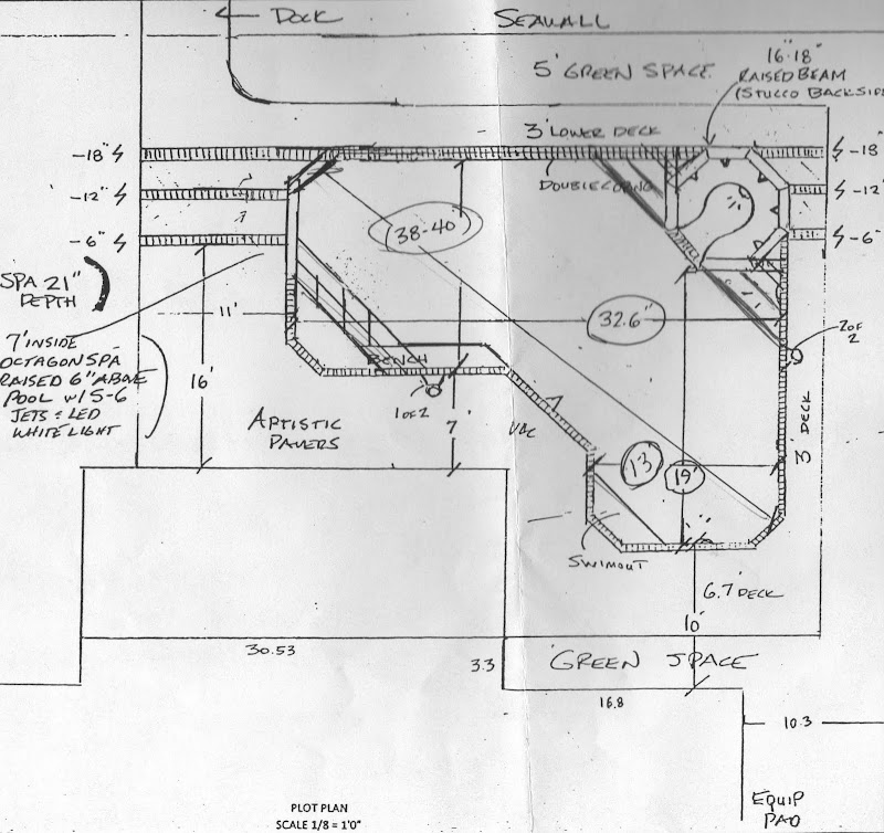

photo test from picasa
From The New Blue Pool
Appears to work in the preview!
RE: New Pool in Saint Petersburg, FL
Here is a link that might be useful: New Blue Pool blog

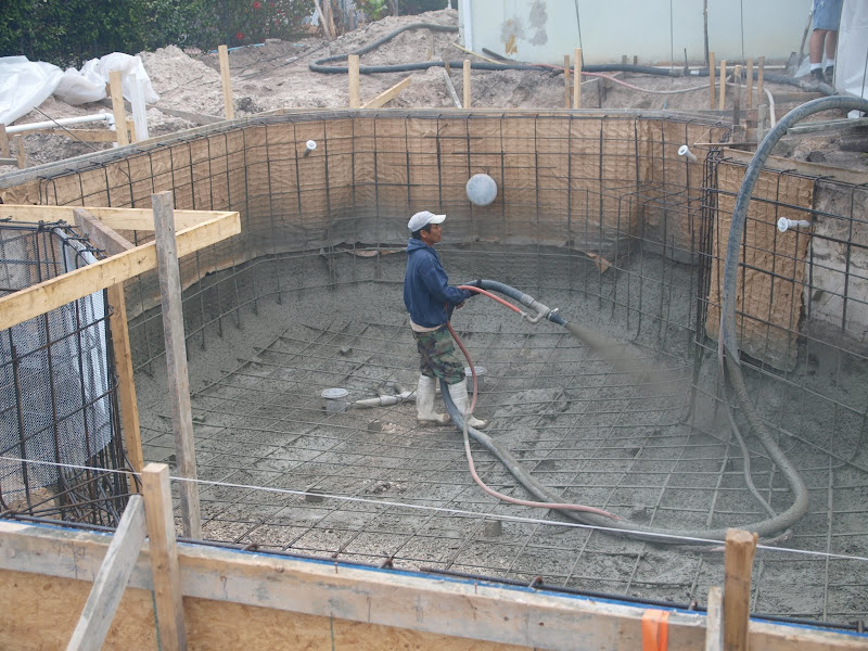

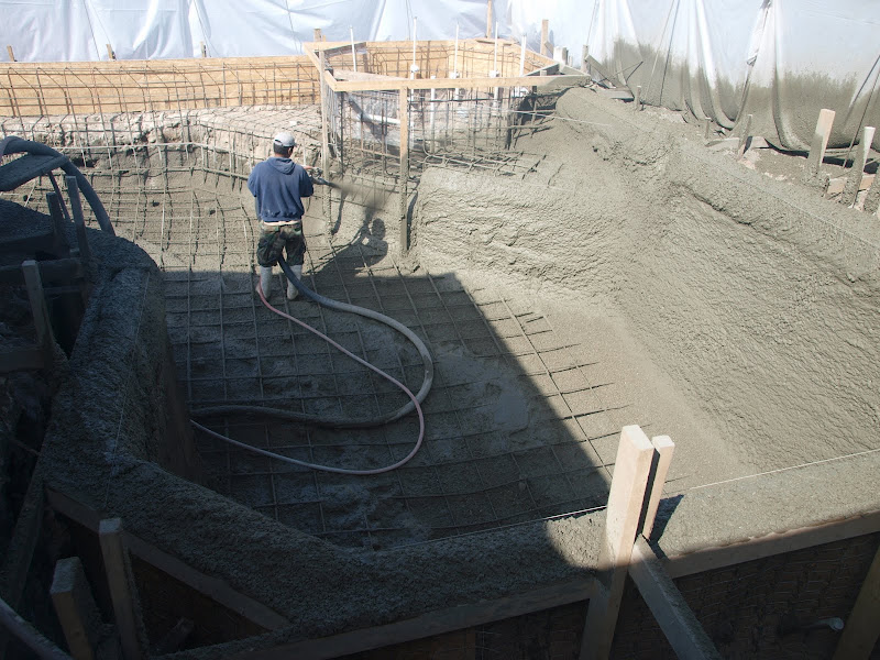

Shooting begins!
Started around 8:15 - first hot steam, then 5000psi shotcrete:
After about one truckful:
And after two truckfuls at around 10:45:
I can hear the third truck prepping out front....

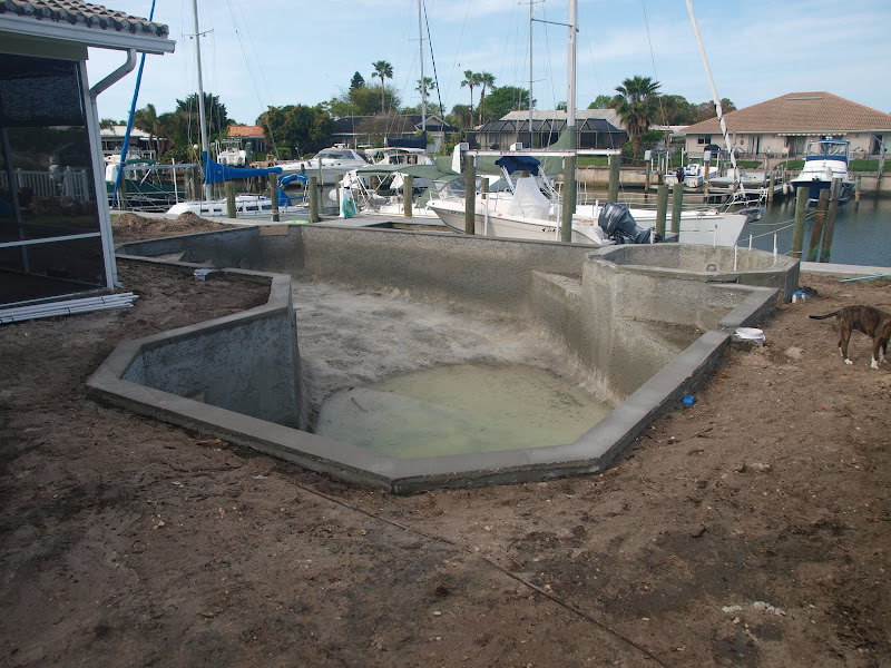

A few days later, framing removed:
beautiful design!
My PB says it's a "technical" pool, which I gather to mean all the angles have to be just right.

Joe,
We are in NS2 zoning so our setbacks are different from everyone else. First make sure you know what zoning your home falls under (can be easily researched from St Pete website). Setbacks are here: stpete.org > "residents" > "permits & zoning" > left blue menu "land development regs" > scroll down to "zoning district regs" and look for yours.
We're required to have 5' of "green space" measured from the centerline of the seawall cap (ours is 3' wide, so our "green space" is actually 3'6" of "green" and 18" of seawall cap). "Waterfront" is 15' back from your seawall. From that point to your house is "back yard" or "side yard". We need 5' from the property line (fence) on the "side yard".
If you are on the east side of the city and need a cage, you'll have additional requirements involving your neighbor's view easement and money, of course.
So, we have 5' "green" or setback, then 3' paver deck, then the pool beam wall on both the seawall side and the fence side. Hope this makes sense.
Our PB talked us through this and I'd definitely recommend him. He's done several friends' pools and I talked to them at great length and inspected their pools. (I immediately dismissed PBs who didn't know the seawall stuff off the top of their heads because that means they don't have enough experience for me.)
Also, we just got a new seawall in December (Dan Sapp seawall) and they put in a span beam explicitly for the pool. If you have an older seawall or didn't build in a span beam, you'll probably have to be back 15' because that's where your tieback blocks are.
Our pool, which is considered "big" for St Pete, was about 3 times your budget. We also have the pool beam wall on the canal side that costs a bit more, but it was the best solution for dealing with the slope of the yard.
