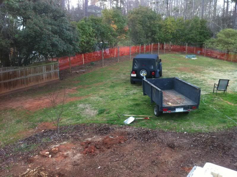

I demo'ed 80% of our existing rotten deck, and removed the relevant fence panels as you'll see in the pictures below. I've got a sketch I drew up that will show you the proposed location of the pool, and an idea as to how to do the decking.
The decking location and design will be decided upon when it's time to pour, i can add as much decking as i want at the agreed upon $ per sq. ft. Since we signed the contract we changed what we want to do regarding our current deck. We are now eliminating the deck and going back with a much smaller one, 18' long that extends 6' off of the back of the house, with 18' long steps descending onto a future patio space that is also the same elevation as the pool deck.
The diagram shows curved lines for pool deck and patio but i'm thinking i want to continue with the shape of the pool and small deck and turn everything into rectangles.
The new fence will go where the old one was, but will be 8' tall. I took out the old fence so that the PB would not have to deal with it (build to it) and so any wall or berm or dry ditch can be located outside of the fence.
View from corner of current small deck (after demo)

Why is the pool so far from the house?
RE: My First Pool Build (North Georgia)
Well that location is the high spot of the 1acre lot. Gets the most sun. If we moved it closer to the house , sliding it south, we would have to deal with a 28 year old trash pit. Also the neighboring houses front windows would then be visible from the pool. At current location we can see their deck but the side of their house facing our backyard has no windows. They also have a giant sweatgum tree that would be dropping seed pods into pool area..... We also have a fairly large backyard and aren't necessarily wanting to crowd it all in but are seeking feed back.
