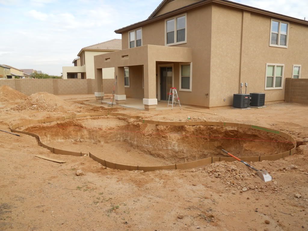

Day (1) today: Excavation completed

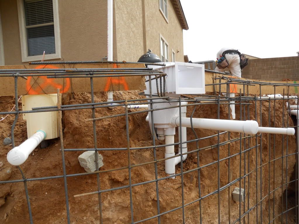

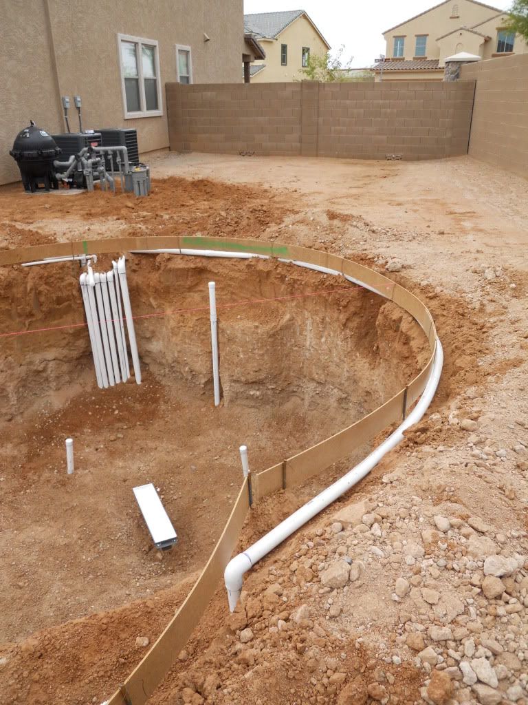

Friday the plumbing was completed. Electrical and rebar is scheduled for Monday. Let me know if you guys see anything in the pictures that should be brought to the pool builder's attention. Thanks!

I am surprised to see the use of flex pipe on a system equipped with a floor system. Been there, done that, won't go back.
I assume the tan tank next to the skimmer is an autofill.
Is that a debris catcher on the other side?
What is tied to the skimmer?
Is that another debris catcher in front of the pump?
Very, very cleanly plumbed.
Scott
RE: New Pool Build in Surprise, AZ (PHX)
Scott,
I dont see any flex pipe, but we do alot of heat bending here. It reduces the amount of fittings, and lowers the TDH, and obviously works great with freeform pools.
One of the small round tanks is a autofill, and the other is a indeck chlorine feeder.
The skimmer is a venturi type with a return tied to it.
And that is a leaf catcher plumbed infront of the pump.

is heat bending a common practice? Is it stronger than fittings? I am curious to know if weak points are established by heating the pipe. I would imaging it would pressure tested at a higher pressure to make sure the material's strength has not been compromised. The reason I ask is because my pool builder had the plumbing contractor replace a couple pipes that he heat bended because he says he does not do any heat bending in his pools.

"Is it stronger" If a fitting is properly installed, no.
Is there way more chances for a fitting to leak or come apart, yes.
Schedule 40 PVC depending on size is rated for around 200PSI operating and 900PSI bursting.
Heat bending does stress the pipe wall some. You are basically stretching the pipe on one side when you are bending it. Pool operating pressures are very low, so there is no concearn about this.
Now just like anything it is a skill to properly heat bend pipe, it cant be burned and charred, you cant make tight turns or it will kink, you cant heat the ends where you want a fitting, ect.

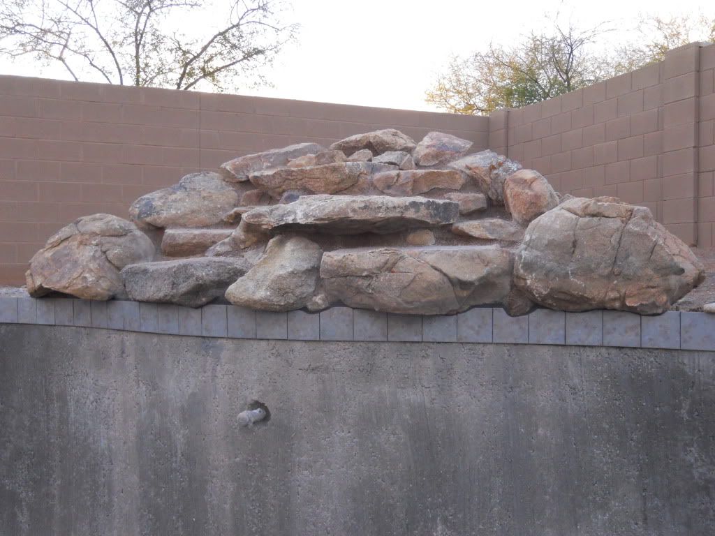

WF was installed today but it was getting to late for any good pictures. Tomorrow they will be back with a new accent boulder since one didn't match the other and then I'll post some pictures. WF looks beautiful and bigger than I expected!

Looks like one of Aquatic Creations waterfalls.
They do a good job, they just all look the same.
It was built by Desert Hills. If it looks similar to their other work, so be it. There's only one for me to look at in my back yard! I'm very pleased with how it turned out too, not real tall and bulky like some I've seen. I'll be doing a tropical landscape theme so it should fit in perfect.

Just curious. What was the looped piping in the waterfall for?

One line is the supply line for the waterfall and the other has been cut off at the base of the shotcrere pad and serves as a "drain" with the return line coming out under the waterfall as seen in the pics.

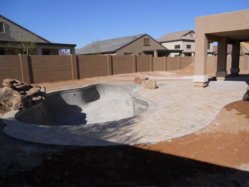

Here are a few pictures of the deck. Walnut travertine 375 sq ft. with bullnose coping. Existing concrete patio is 200 sq ft. Looks beautiful! The interior will be applied in the morning!

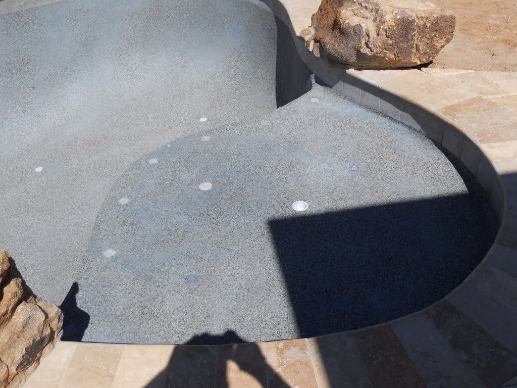

The pebble interior was applied this morning and tomorrow they'll be back to acid wash it and start the fill. The color is "Catalina Blue" (ShastaStone) similar to Tahoe Blue (PT).

I noticed they did not put any trim or a soldier course around the outside of the pavers. Those small pieces that are cut will break off easily.
I dont think I have ever seen it done without a trim.

The pool was filled as of last week Friday and looks beautiful!
Water features were briefly turned on during the equioment start-up
Day 2 with start-up chemicals

just-a-pb- At first I wanted a soldier course but I really like the look without it and in pics posted on this site. The "odie" pool was done that way too. Can't wait to get the landscape done, but It'll be ahwile before the funds to get "restored" lol
