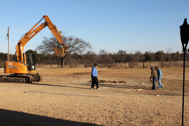

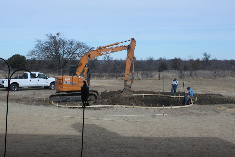

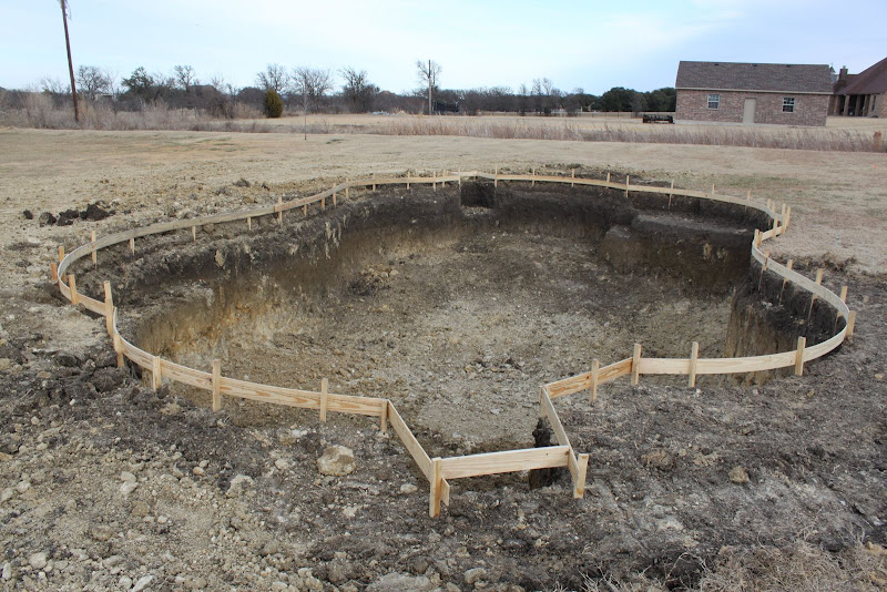

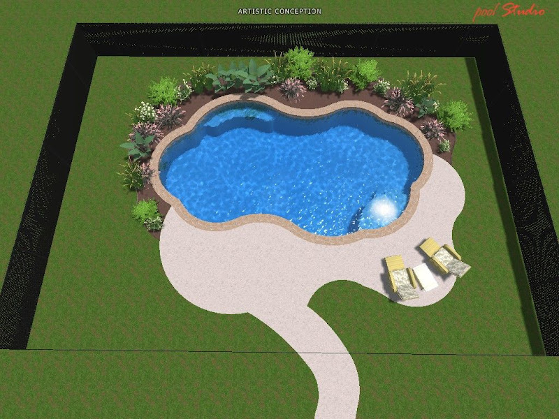

RE: New Pool Build in Aledo, TX

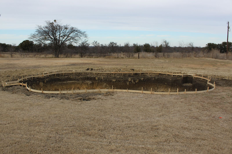

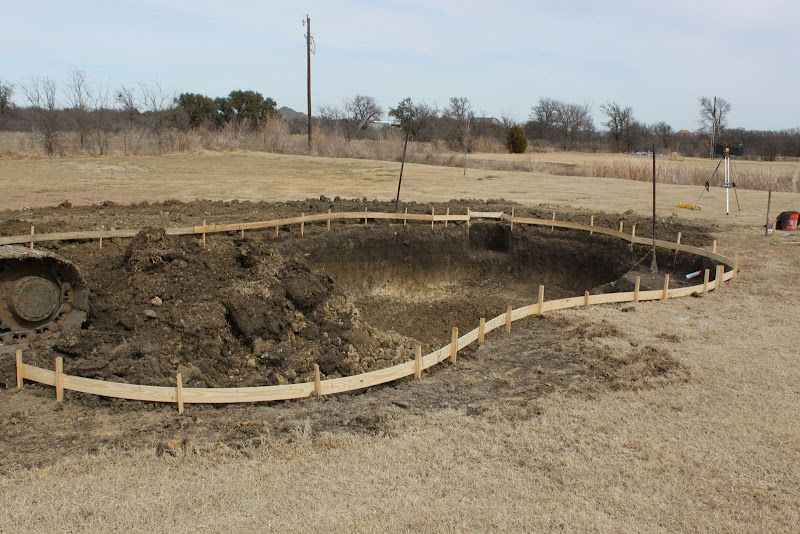

| Here is the pool shape. We made some minor tweaks and added a different decking layout around the pool.
They started the dig today. What a great crew!
Horray! No rock and done in a day. Those guys are fast! |
Looking Good! It can seem like a whirlwind how fast some things move right along. Our build was completed in August 08 and we were 33 days start to fill. That did not include the sprinklers, sod, landscaping etc. We did not build a spa either. While I'm sure the teenagers would use it, the husband and I would not, most likely. It was not worth the expense for us. Someone mentioned on another thread about there not being enough decking. After they do the coping, you can get an idea of by laying a garden hose, where your deck lines will lie. We changed ours when they came to set the forms and rebar and are very glad we did. One can never have too much decking or closets! Keep the pics coming |
| Thanks for the suggestion on the decking. The PB is going to lay out what we have and I already told him we will want to add some more. He was fine with it and said they would allow us to add as much as we wanted at cost. Also added an auto-fill line to the mix today since the plumber will be out tomorrow. Didn't cost hardly anything and will be a nice convenience when it gets hot in the summer. |

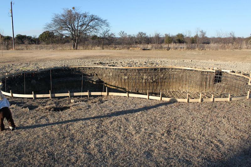

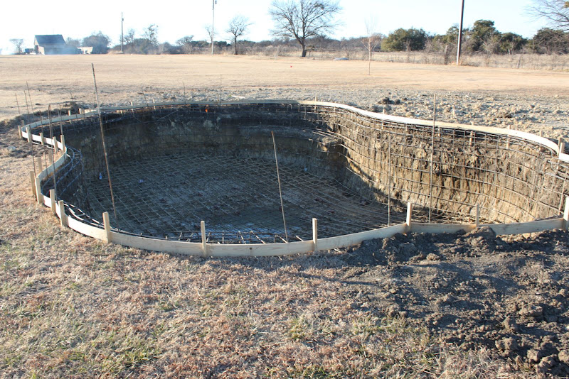

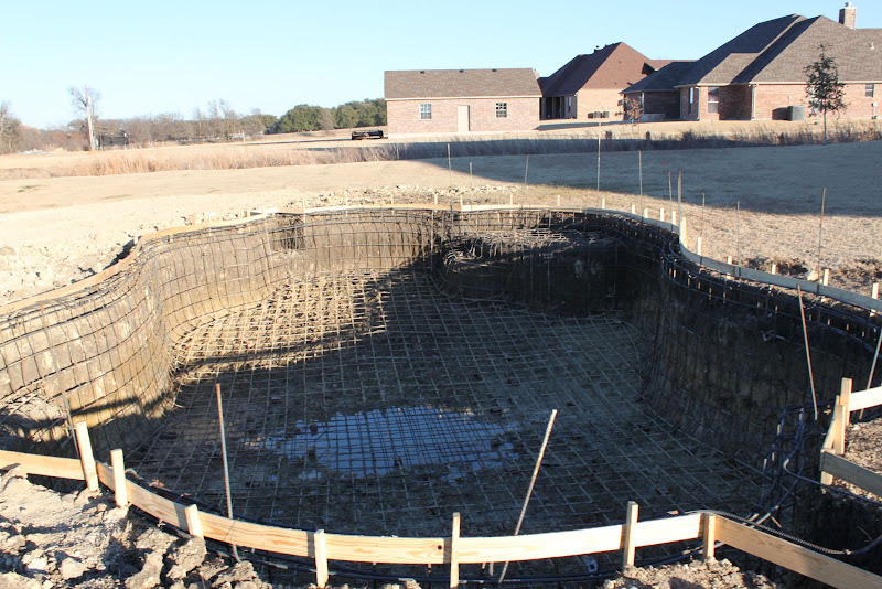

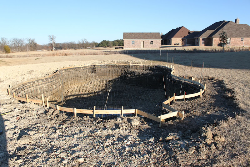

Day 2: Rebar Is In
| We had another beautiful day here in Texas. The PB and crew are really working hard and got all the r-bar in today. Tomorrow we will be getting plumbing and Saturday will be gunite. I can't believe how fast this is going. Here are a few pics from today's work.

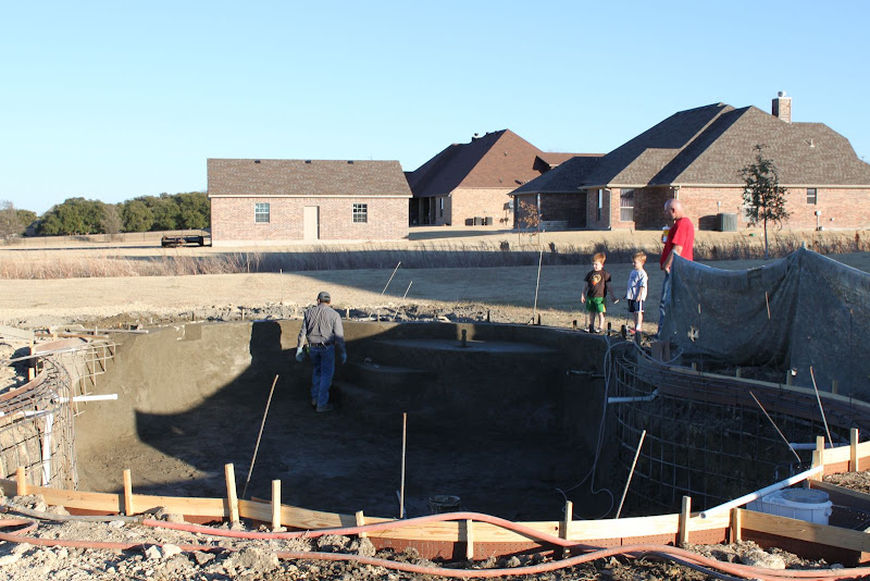

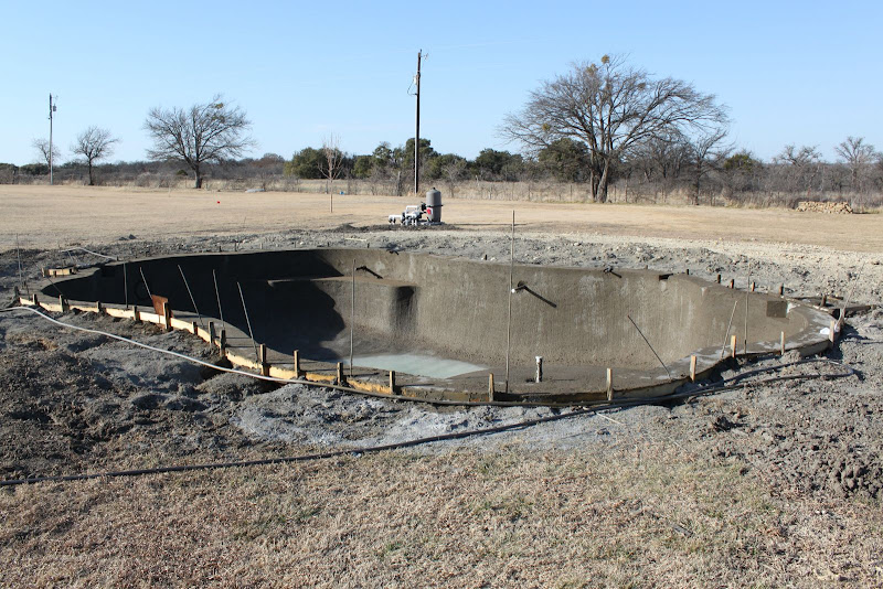

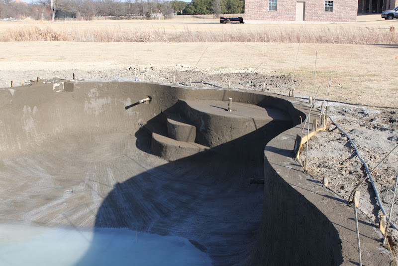

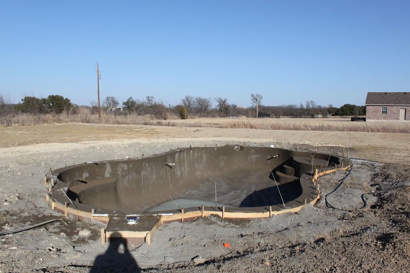

Day 3: Plumbing and Gunite
| Wow! Today was a whirlwind. I left for work this morning and the plumbers came and ran all the plumbing. They finished up in the early afternoon and then the gunite company showed up and they just finished (about 8 PM). So, there you go... four days after I signed the contract. I had no idea it would be this fast. Here are a couple of pictures from this afternoon. I will post some more in the morning once the sun is up and I can see the finished product.

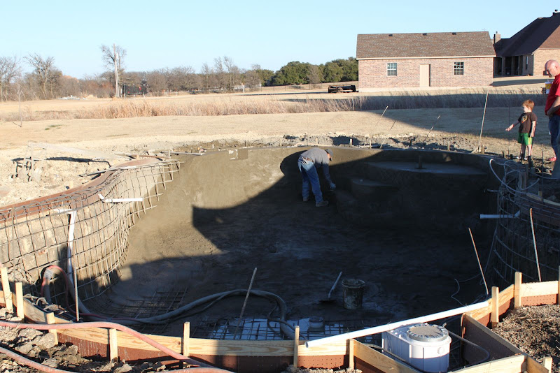

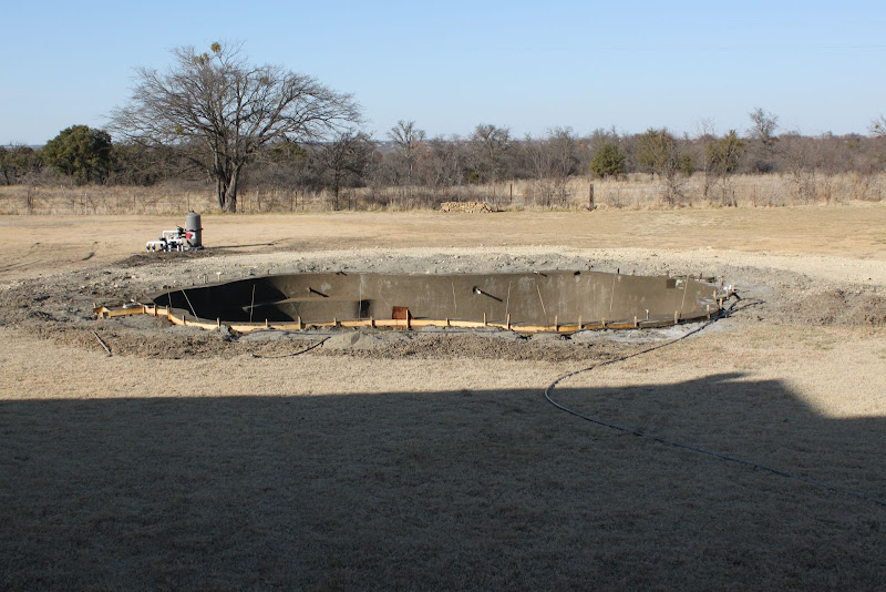

Day 3: More Gunite Pictures
| Here are some more pictures from the gunite. I started another thread this morning because there was a crack that developed overnight. Fortunately, the gunite company is coming back out to reapply in that area and fix. So all is well.
Here is the equipment.
RollTideTX, Just an observation/comment FWIW. Appears there is a lot of existing grass around portions of the pool. This material should be removed prior to putting down the deck. Good luck. |
| Thanks for the observation! They are going to be cleaning up, grading, and prepping the deck area around the pool next Monday and Tuesday. I will post some pictures when they do. |

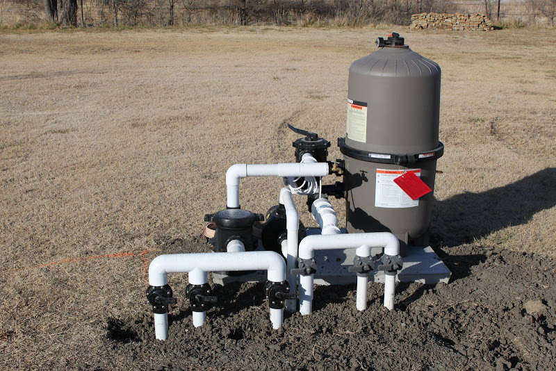

I would recommend building a protective/shade cover for the Pool Equipment to protect from the elements. This will help extend the shelf life of the equipment and protect exposed pvc. Have the builder spray the exposed pvc with Almond Color paint..... Also, the single Hayward Colorlogic will not provide sufficient light from the deep end to the shallow end...I am a pool equipment distributor in So. Cal and wish I would have installed (2) Colorlogic Lights in my pool. Too late for you unless the builder can work some magic. |

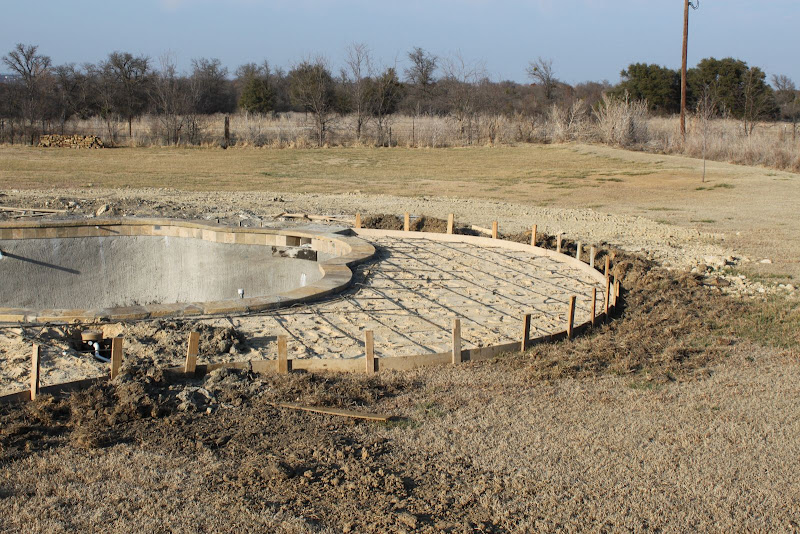

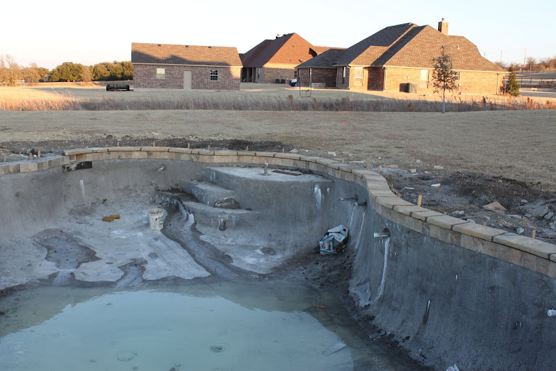

Coping
| Came home today and the stone guys were installing the coping. I was extremely excited to see how well everything matched up. I can't wait to see the final product! Here are the pictures. I will post more when they finish the rest of the coping.

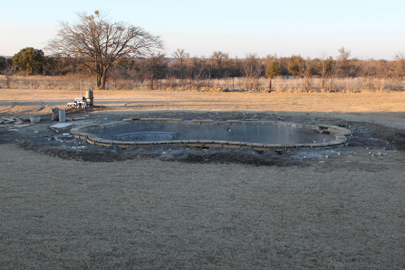

Finished Coping and Pool Deck Prep
| We had an extremely busy day today. Finished the coping, electrical, and then had the deck shaped out/prep started. As you can see from the pictures, the left hand side of the deck is squared off. We are prepping that side for Phase II - a 24'x18' cabana. I am in negotiations with my pool builder and the guy who built my house to get some construction plans drawn up and an estimate. We are considering going ahead and pouring the foundation for the cabana and getting it ready for construction in early Spring. Any thoughts from the group? Good idea or bad idea to go ahead and pour the foundation even though it may sit for several months? Anyways, we are having a lot of fun and enjoying the process!

| I would wait. You're going to have utilities to run like water and sewer. It's a lot easier and less costly without the slab there. I don't see the bond wire. That is part of the electrical. Nor do I see grid around the pool or a gravel bed for the slab. Scott |
| Thanks for the input. Knowing that we are going to be putting the cabana in soon, do you think it makes sense to square off that side where the slab will be poured? We are willing to live with the odd shape since it won't be that way for long. Not sure what the bond wire is, but there was conduit with wire that they buried today and piped to the house, equipment, and pool light. They spent all a good part of the day working on it. I will ask the pool builder to be sure. The grid and gravel will be done tomorrow for the deck. Today they just shaped the beds out to make sure were happy with it before they started the rest. |
| I urge you review the search results. NEC codes are quite strict on this important electrical safety requirement. Scott |

| Will do. I am meeting with PB this morning and will bring this up. I will post back what he says/shows me in regards to this. |
| Spoke with my builder and he indicated that the bond wire is there and will also be connnected to the steal in the deck as well. Not sure if I am saying that right but he said the electrical meets all NEC codes. |

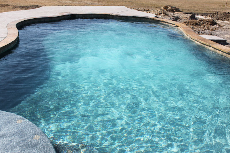

Plaster and Fill
| We had the pool plastered and filled with water last Friday. We went with a dark gray plaster with black quartz. I was a little terrified when they were spraying it on as it was like black tar, but it came out perfect! It is the exact color I wanted. The pool is now having an acid bath and brushing to bring out that quartz. Tuesday, they will be grading, cleaning up, fixing sprinkler heads and installing irrigation behind the pool area for our landscaping. We are very excited about the fun we'll be having this summer!

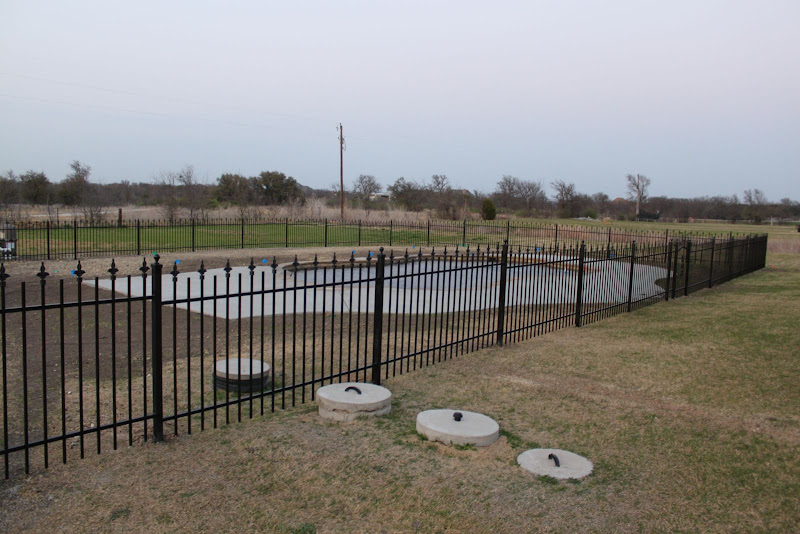

Wrought Iron Fence
| They finished installing the wrought iron fence today. It really finishes off the area around the pool with class and keeps the little ones safe. Next up is landscaping! But first, take a deep breath! :)

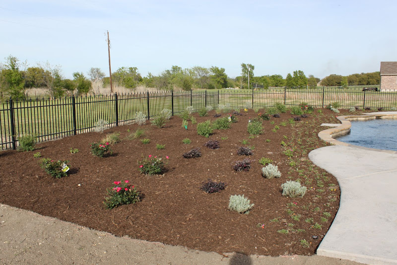

| We added our first phase of landscaping around the pool. We went with mostly native, sun-loving plants that will add some color and variety to the landscape. We will be adding crape myrtles along the back of the bed and Leyland Cypress trees on the outside of the fence for some privacy.
