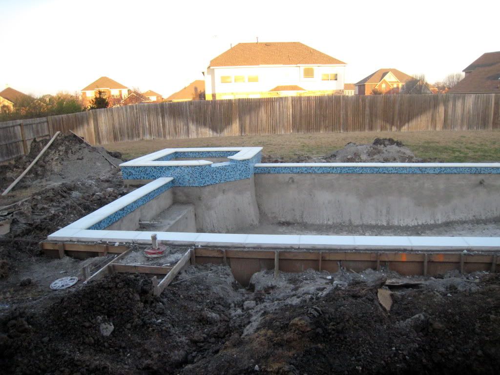

We've gotten a lot accomplished this week. Here's updated pictures of our gunite, coping and most of the tile:

Jenn - it really looks great! Those are some pretty blue tiles and are going to be beautiful with the sun reflecting off of them.
RE: New Pool Build in Murphy, TX
Jenn, I love your blue tile. What is the name? Also, Hobert is on our final short list of companies we are considering. We have received 2 quotes so far and theirs is $15K less than the other and includes a spa. Are you still happy with the work and quality of Hobert so far? Did you happen to check any references with pools that they built 10 or so years ago? I am curious as to how their work holds up in the long run. I'd love to know your thoughts. Cindy
Cindy, the blue tile is in their Richardson showroom and is called Oil Blue Iridescent tile. I think it's also used on one of the show pools at the Richardson office. Still happy with the work and quality, the project manager has been very responsive and has driven out to our house for something as small as a 5 minute review meeting. We did see a couple of pools in person that were built over 10 years ago and they looked to be in great shape (with the except of some which had owner neglect).
Is that considered a glass tile?
Yes, it's a glass tile and was an upgrade that they "threw in" for us.

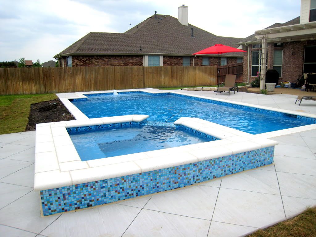

Well, we finally filled 'er up with water about 3 weeks ago and have been busy trying to get the chemicals balanced. Finally there, and it's pretty easy thanks to recommendations on troublefreepool.com. Have had two hot tub parties since then which have been a blast.
Here are some final pictures with the Blue Mist Sunstone quartz plaster we chose, all sod laid down (5 hours yesterday and backbreaking!), and some new accessories.
Looks great. Glass tile really makes it pop. Decking looks outstanding. I wish my project could go as fast as yours....
