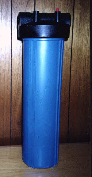

If sediment then it may settle down after a while or you can install a 4x20 Big Blue filter housing with a sediment cartridge in the correct location and sequence (depending on your well and treatment equipment layout) that looks like this...
Avoid smaller dimension housings as they can limit flow.
