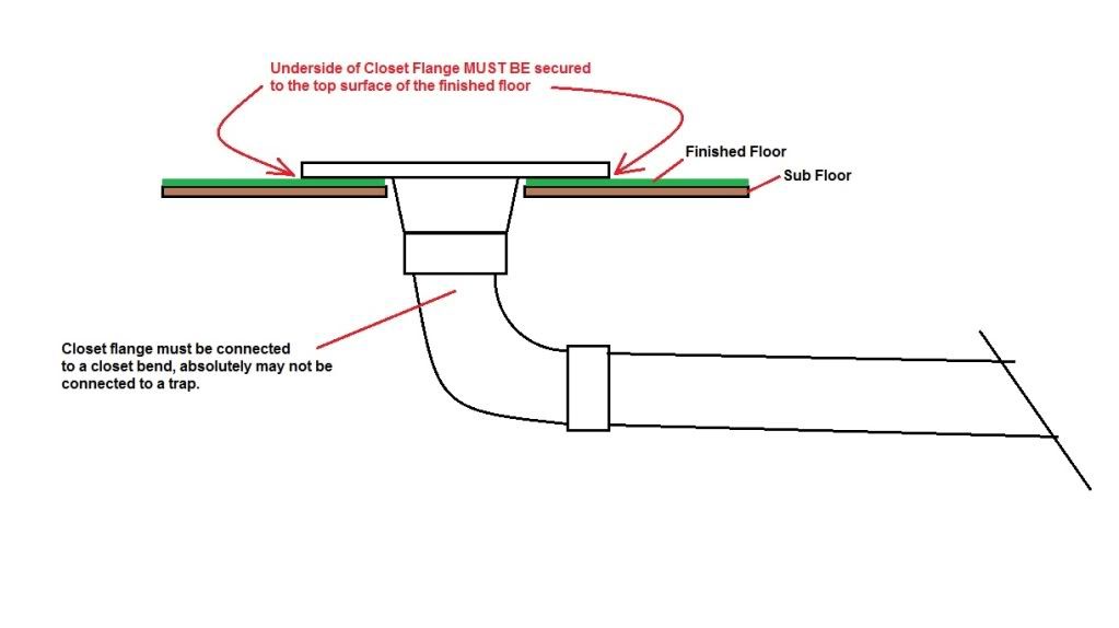

    It is more likely that he is referring to double wax rings, which is a total code violation.
    Per code, the underside of the closet flange is to be in firm contact with the finished floor, which leaves the top surface about 1/4" above the floor.
    Code prohibits installing the flange flush with or recessed below the finished floor.

    Closet flanges are made to very strict ASTM specifications so you need not worry about the thickness of the flange, however the flange MUST BE mounted so the underside of the flange is securely fastened in firm contact with the finished floor.
    The thickness of the flanges and the vertical recess in the bowl are both carefully controlled so that the Wax Gasket can effect a proper seal.

    Thanks for the clarificatin, lazypup. What software do you use for drawing - nice job.
  • lazypup
    12 years ago
    I use the microsoft "PAINT" program which is prepacked on most computers

    Question for lazy pup,
    You said the closet flange must be connected to a closet bend. When using 3" lines is it possible to connect the toilet flange to a long radius 90 and a length of pipe instead of a closet bend? Is it better to use a closet bend?
  • lazypup
    12 years ago
    A long radius 90 would be acceptable.
    Under the code the water closet must be on the upstream end of the line. It may not be connected to a Wye & 1/8bend, Combo or Tee.
