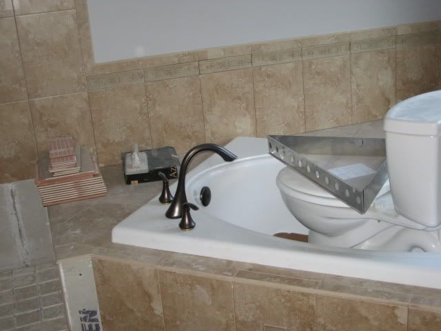

We are in the middle of our master bath remodel. I had a new faucet and plumbing installed for our roman tub (Moen Eva). The handles are to sit flush on the deck without an eschutcheon ring. Well there is a space between the deck and the handles (the faucet is mounted correctly). My contractor insists there should be rings and I know there aren't (and to try and satisfy him and get him to listen to me I called Moen). Moen told me to cut down the stem extenders. He cut down one a bit and it still looked the same. Is it possible the rough-in valve is too high? They will have to rip off some tile but I don't care, I want it right. A plumber (not the contractor in question) put in the valves, but I want to know what I need to tell them to do.
I apologize if I used any wrong terms. Thank you.

Here's a picture. The toilet isn't in the tub anymore. LOL It's just the best picture that shows the issue.

If they are snugly installed, the handles should screw further down. Try grabbing the wide part with your hand and turn it.

Thank you for the instructions, but I all ready had them and provided them to the plumber and GC. We also have grabbed the wider part and continued to turn. Where they are right now is as far as they would go, they won't go down any further. So I am still thinking either the stem extensions are still too high (but the handle with the one cut down looks exactly the same as the other handle) or there isn't enough room for the handle to screw down all the way. Ugh.

Whatever it is, it's repairable from above. Looking at #6 of the instructions, maybe someone didn't turn the cartridge before they installed the handles...or maybe the cartridge is not fully inserted or screwed in. Just a thought, esp. since I've never seen a plumber read all the directions. Not that don't, per se. Anyway, good luck.

They still need to do the sinks and sink faucets (we decided at last minute to go ahead and get new vanity cabinets so that added a week or so). So when the plumber is back for that, I will have him try what you suggested. The water runs fine it just looks like crap. Thanks. Any other thoughts are appreciated as well.
