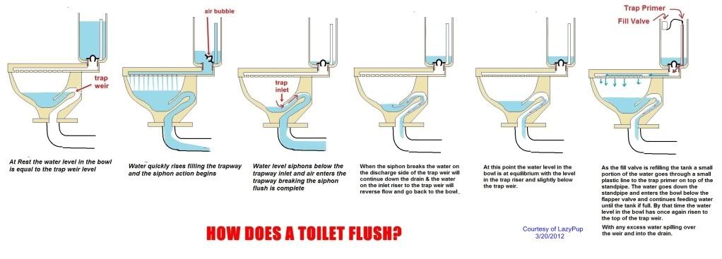

"nearly all low flow toilets"
With no indication of the actual age of the toilet there is no way of judging if it is a "low flow" type.
And even in the diagrams, the air ob the output side of the trap has to be able to move for the water exit.
See picture 1? All the4 air needs a place to go for the water to start flowing as in picture 2

RE: Toilet swirls, but won't flush!!
alice: I have the same petpeeve.
Looking at that diagram that lazypup posted, the apparent simplistic design of a toilet harnesses the laws of physics (fluid dynamics) perfectly.
Beautiful. And much nicer than pooping directly into the hole in the ground.
