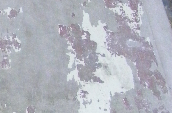

Best paint for a steel bulkhead? This was painted about 5-6 years ago with Muralo Alkyd/Linseed Oil Exterior House Paint. Appears primed with something, I don't know what. There's a bit of rust on the frame, but I'm not too concerned about that for now.
prescraping:
scraped:
Also will be washing it down first with some tsp or bleach.
I would prefer not to use oil paint, but will if it is necessary. I have latex primer on hand. can I use that?

Hmmmmm....how flaky is the remaining paint/primer??
It almost looks like it's still peeling?!
I'd consider taking it down to bare metal again using a wire brush on a drill.
* Wipe down with Lacquer thinner.
* Prime with a good full coat of 123 Latex. There are some rust inhibitors in 123.
* Also a thought...take them off and use a spray primer like Rust-oleum Professional. This would actually be my 1st choice!
* Final paint coats could be sprayed or brushed on. Use the highest practical gloss. DO NOT USE FLAT.

I think I scraped about 98% of every loose scrapable edge. Drills and wire brushes probably not going to happen. Maybe you are seeing the dirt/mildew layer. close up below. WIll the lacquer thinner clean that up too?
Is that dark red under finish the "bare metal"?
Great idea to spray. I'm not likely to take them off (above my pay grade!), but opening them should make them vertical enough. I can protect the overspray I think. And thats a more palatable way to apply oil-based product. fast and disposable. Can I do the same with the finish paint?
