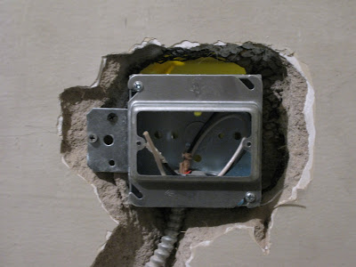

Jan, this room was never remodeled before. It was the original kitchen from 1948 with backless painted wood cabinets "built-in-place". The wall in question is a very thin plaster wall with no studs or any structure.
Here are some photos of the wall after removing the old cabinets and doing the electrical. In one picture, you can see some green around the junction box - that's the light shining thru from the living room. The wall was so thin that when the electrician put in the junction box, it went straight through.
So when the contractor was figuring out how to hang cabinets on this wall and make them secure enough that I could store heavy things like dishes, the solution he came up with was to use glue. I don't know what the other options would have been.
RE: Experience gluing cabinets to plaster walls?
Take down the old wall and put up a new one? It's suprisingly inexpensive and depending on old walls in that shape to hold new and probably heavier cabinets to me would be very scary!

No studs? Just a wall of plaster? How does it stay up?
If it's really just a plaster wall as thick as a junction box, then I would say that taking off glued cabinets will destroy it. And I agree putting up a new wall would be a good idea! You say it's an apartment--are you just renting?

Thanks, everyone! Just to clarify - the wall appears to be cement and metal lathe with a plaster coating on both sides. There might be thin metal studs supporting the lathe. There's been a lot of discussion over on the Kitchen forum about whether this wall can support the weight of the cabinets and their contents, and how best to secure them... I believe the wall *can* somehow support it because it had cabinets on it before, and everyone else in my building has cabinets on that wall (though I don't know what techniques they used).
