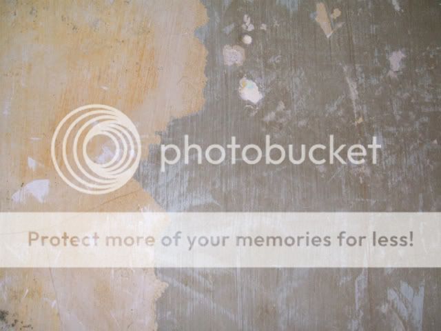

scraped off the wallpaper and found this..a gray thin plaster layer with what looks like yellowed glue over the layer under the gray. Do I need scape the gray layer off before I paint?Photobucket

RE: plaster wall 1
I removed a layer of painted wallpaper & some of the gray layer scraped off with the paper. The thin gray layer appears to be part of the plaster process. Don't know for sure but is that right that I should scrape off the gray layer before painting?

What you do depends on (a) what happens when the layers you have get wet, and (b) what effect you want to have after painting.
I can't tell from the photo what is layered over what, and the colours are different from mine, but I think you can figure it out if you see if anything softens up when you spray it with water - that will soften up when you paint. Anything that isn't water soluble can stay on the wall.
Then the next question is just how smooth you want the wall. If smooth, you'll need to even out the layers, either by removing or adding - adding is a lot easier; just some spackle to soften the transitions or to fill whole craters, up to you.

Gray is the top layer and it's very thin. I was thinking I might have to skimcoat to fill it out which won't take much. The wall areas are divided by floor to ceiling windows so should be easy. This was the first area so now I'm being very careful. Sherwin Williams told me to score the paper then spray fabric softener/hot water and let it set 5 min or so.

The grey layer will come off if you get it wet. You need to scrape it off with a wall paper scraper( big razor blade). If you just want to skim over it, prime with Gardz first and after.
