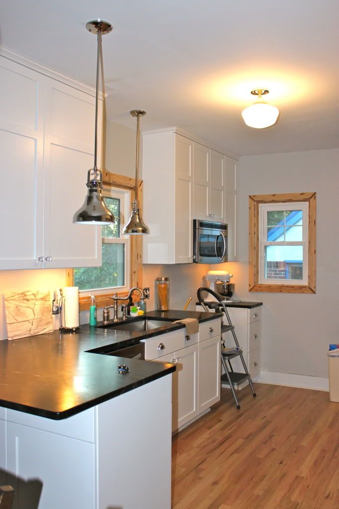

    12 years ago
    DMK1974,
    I can certainly empathize with you and your window dilemma. We debated our decision for quite a while, too. In the end we decided we didn't want to lose the light by closing up, nor did we want to compromise the counter space by leaving it as is--that left us with one option that worked for us, which was to replace it with a smaller window and fill in the gap with bricks from another window we enlarged over the sink. I realize many might scoff at our solution and space plan of our kitchen, but we love it! Best of luck to you! Kitchen renovations are hard enough without decisions/complications like this!
    I've included pictures of our kitchen with new windows (albeit, not quite finished since we have slowly DIYed the whole thing)
