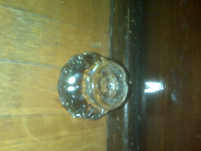

Is there an easy way to reattach a glass knob that has fallen off the metal hardware on an interior closet ? I can pop the knob back into the handle, but it is loose, and eventually comes off. The only advice I found on the internet was to attach it with eopxy.

The part of the knob that fits over the shaft is OK- the set screw is tight. The part that fell off id the glass knob. I will try to post a picture

brickeye - thanks - glue/epoxy may be the only option ?
I have linked pictures:

I would try one of the instant glues first and see it there is enough area for it to hold.
RE: glass door knob fell off
If the instant glue doesn't work, use an epoxy that dries clear...

Instant glue worked great (so far). Because of the ridges on the knob and hardware (for the knob to grip the hardware- there was plenty of surface area).
