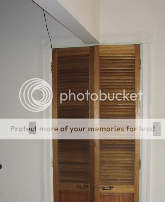

We had this: The upper jamb in this doorway held up the header. The header supported part of a staircase and the wall of an upstairs bedroom. Somehow that door still opened and closed.
