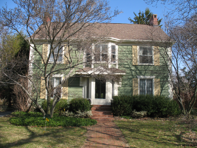

I live in a wonderful 1922 Colonial Revivial. I love this house, but I have always sort of wished that we'd looked for a house with a front porch. I love front porches and there is a house a block away with my ideal front porch. Yesterday I thought to myself that that porch is really just added to the front of a basic Colonial Revival. (OK, it has a hipped roof, but still...) The porch has a kind of Craftsman feel that I love and that blends well with colonial look. So I took a couple of pictures and came up with my house with their porch, and I kind of like it. The external of my house was redone in the 80s, so there are no original features to disturb. Obviously in the picture the porch's roof line is all wrong; don't worry about details, just tell me what you think about my house with a porch.
RE: Thinking About Adding A Porch
I admit, I also suffer from "Porch-envy". Personally I love the look of you house with a porch. The only reservation I would have is whether to balance it more by going the full width of the house. Are the windows on the porch from your house or part of the "borrowed" porch? If they are yours then the balance won't appear as off since the windows are different from the right side of the entry anyway. I think there is nothing better on a summer afternoon than spending a little time just relaxing on the porch and miss the one we added to the last house we owned. I now own a 1832 greek revival and have been doing the same thing as you, looking for the perfect style and snapping pictures to try and see how it will look. I say go for it, you wont regret it. :)

I love porches, but my honest opinion is no. You are turning a symmetrical house into something asymmetrical and it doesn't work for me. I would go for the country look and take it all the way across the front or find a way to put it on the side.
Love you color palate.
I love porches....but that porch is all wrong for your house. With that style house the porch goes to the side...I would put a porch to the left as you are facing the house.
Lots of houses in this neighborhood have side porches, but my house won't be one of them. We are built to 5 feet from the property line on the east (right) and 10 feet on the left, and that's where our driveway is.
The porch goes on the front, or it doesn't go at all.

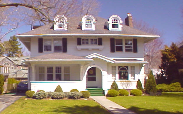

You know, I'm not sure I fully understand the objection to the asymmetry. This picture is of the house from which I stole the porch to photoshop onto a picture of my house. It has the asymmetry, too, and yet I think it's one of the handsomest houses in our neighborhood. It has a lovely weight to it. It doesn't look unbalanced to me.
Obviously I would not add that specific porch onto my house; the roofline is all wrong, and open railings might be better, although I like the cozy feel of that low wall. But we'll see what my friend and I can come up with. One of the things I want to look at is perhaps echoing the shape of the entryway and our library above it.

Your original idea for the porch addition is totally inappropriate for a colonial style. Your house is more formal, and should have a more formal porch.
Here's my two cents: I love the quoins at the corners, which add a lot to the house--and the bay over the front door. Why not mimic the shape of the bay for the central part of a whole-front porch? I'd stop it just short of the quoins at the corners, with the center part extending further out than the rest of the porch on either side. This central part should have a very shallow pitch, perhaps with a decorative spindled railing to accent that part. The rest of the roof should be a shed roof. The columns I picture are round, preferably fluted with nice bases and capitals. A spindle railing about 27" high would fit the scale of the house--don't do the stock 36" as it is too tall in proportion. At the steps, make the railings come down from the columns, not tacked on at the side and then coming down.
From the top, the porch would be laid out like a 'T', but the longest dimension would be the crosspiece, not the vertical part of the 'T'.
That "original idea" is just a rough approximation. I photoshopped a porch from another house in the neighborhood onto my house. I realize that's not the right porch.
The bay over the front door goes all the way to the ground. The entry is also a bay; the house originally had no roof over the door. That bay shape ran uninterrupted from the stoop to the roof, and the roofline actually is brought out in that same shape. My thinking was something that will echo that shape in some way. I like the column idea.

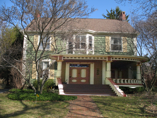

Ha ha ha! OK, my architect friend came to sketch, and I haven't seen all of her finished drawings yet. The first one was all right, but it had a shed roof over the porch, and it just looked... ordinary, I think. Not bad, but not striking. So I resorted to stealing other people's porches and gluing them on to the front of my house.
This one makes me laugh because I had to stretch the porch to get it to fit, and that makes the door and the steps look ridiculously wide. Plus, of course, the colors and the gingerbread are ALL WRONG. Please don't tell me that, because, believe me, I get it. But I really do like the curved corner and the flat roof, and the columns are really nice.
Curved corner or no?
Wow!!
I vote for the curved corner!. The ballustrades and the columns are great, lending a lot of character.
Before I read your text, I thought, it was a mighty wide door (hehehehe) and understand why now after reading.
My comment: The doubled doorway beneath the bay window is perfect. Maybe side lights? Don't let it get too heavy, but stay in balance with the upper floor window sets. Around the double door and the transom light (leaded glass design?) that looks like a wood infill but could just be more of your lapsiding.
The REAL beauty is the rounded side porch...a ROTUNDA appearance. The molding at the top with its horizontal design gives a spacious feel, elongating the house, giving it a horizontal element not present elsewhere. The same is true of those GORGEOUS steps. How inviting!
You'd have to make a broad walkway with a couple of benches half way up. I get an Italianate feeling with the side porch. Either a big frilly lacy light colored hammock hangs on such a porch, or else a nice round table and really comfy chairs inviting folks to come by for a visit and some good conversation. I think THIS porch really gives your house an atmosphere.
