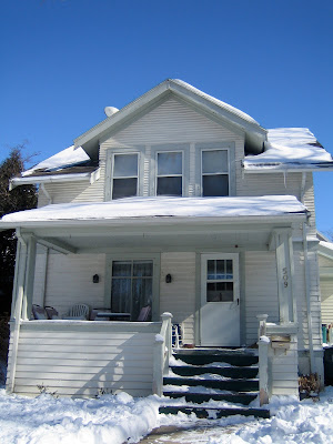

You just helped me with the exterior of my house and suggested shingles, which I had not even considered. Would you mind taking another look and offer any additional advice about trim, porch, any other ways to improve the look of my house?
I really liked the shingle idea (though I had been thinking a stucco look) though perhaps not with staggered shingles, maybe random squares but a straight edge (see I am learning!).
From House

Your house has lines and detailing appropriate to what is is. Other than the replacement siding, it seems fairly original. It's quite possible that it had some timber details (knee brackets) on the roof overhangs at the eaves and gable. But even without them, it's textbook bungalow.
My suggestion would be to learn what color schemes were originally popular for bungalows, and select within that palette. Warm, earthy colors were favored; blues, grays, whites much less.

I agree with Casey. Paint would help a lot. Something rich and earthy. Google bungalows and you will see some great examples. You house really is nice looking!

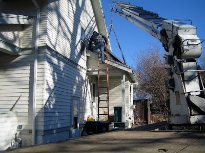

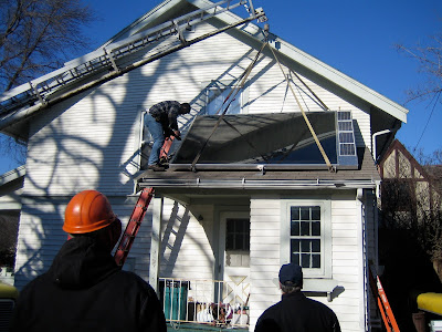

Macv, here are a couple of pictures if you have any additional input. The back of the house faces another yard, and is only distinguished by a solar electric array (and there is no backyard at all).
The color I am thinking of painting the house is Compatible Cream (now, thanks to macv, probably on top of shingles rather than lap boards). It is a Sherwin Williams color that is kind of mustardy-yellow. Thinking trim portions would be white, porch blue or gray, to be determined, not sure. While I do love those cool colors, as you can see the weather takes care of all the cool one might need. Also, I don't want too many colors--this house doesn't have anything like those lovely Victorian details that I'd need to highlight.

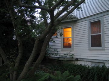

And here's a better picture of the side

This is the belt line I referred to earlier with the siding above it flared out over it. It is very important to keep this detail.
I've never know a two story house to be called a bungalow or for that style to have a belt line not that it matters.
