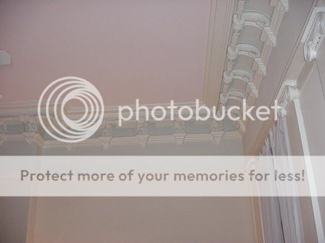

My Greek Revival House has no crown on the top floor, and apparently never did since some of the junctions are original wall against original ceiling.
On the third floor it has cornice but it is not crown at all, it is much more horizontal than vertical.
Here is the fourth floor, the window trim is not original to 1838 here,
On the third floor the hall has a more complicated moulding:
While the main room is simpler: essentially one less "bead" on the horizontal and vertical than in the hall. But it extends further out than down.
The main floors

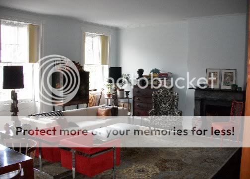

Totally off topic to your discussion, but the main floors had very elaborate cornices, but the ceilings were quite tall (14'). This is circa 1839.
