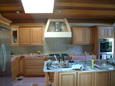

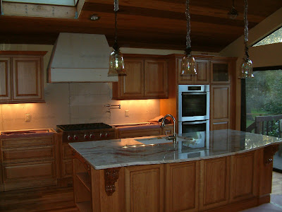

We are in the process of remodeling our kitchen and plan on replacing a few 6" recessed can lights and adding some. We have redwood ceilings and want either a copper/bronze trim ring or black. The ceiling is sloped (4/12) so that is really limiting our options. Any recommendations?? Also, we have found the halogen lights pretty hot standing under them. LED seems to be not quite there. Please provde your recommendations. I do want a warm light. The pictures below show what we are working with.
Steve

Stay away from Home depot, Lowes and the internet. Go to a reputable electrical/lighting supply house to look at the fixtures and get some free advice.
Do you intend to remove the redwood to install new housings? If not, what is the fixture brand and model number of what is there now?
In 40 years I have never seen a recessed sloped ceiling light that I liked. The openings are too large and/or in a kitchen they inevitably put light on your head instead of on walls or counters where it belongs.
I would build a redwood soffit at the top of the cabinets and install 3 3/4 inch low voltage recessed lights in the horizontal surface. That would get rid of the odd gap up there and put some light where you need it.
