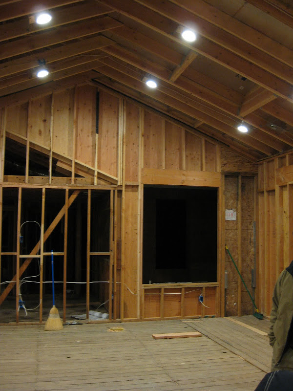

Thought I'd follow up with some pics of the LED Cree LR6s....my lighting sub hooked up the lights to make sure I felt there was enough light. I have a sloped 14' ceiling which will be faced with tongue and groove paneling--therein lies the problem. There is no way to change the lighting after the paneling and the steel roof is put in. It won't be like drywall where you can just cut it out and re-do. So we mocked the whole thing up today and waited until dark...ta da!
Twelve cans in a 22' x 13' kitchen.
From Menlo Farmhouse

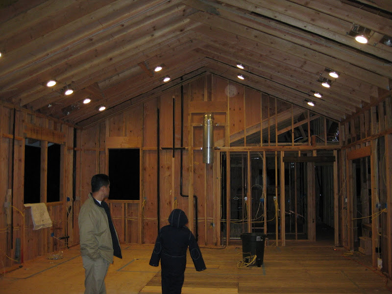

The breakfast nook has 4 cans in the middle of the great room:

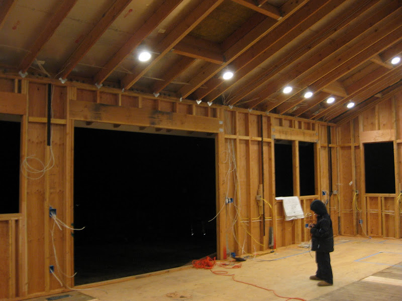

Six cans above the family room section:
It's difficult to truly capture the lighting with a point-and-shoot camera in the dark, but I think you can tell that it's plenty bright, even without the white T&G ceiling, the white walls, white cabinets and white counters (can you tell I like white?). I will also have flourescent undercounter lighting, two pendants over the island, a gooseneck sconce over the sink and a chandelier over the breakfast table. We got light!!!

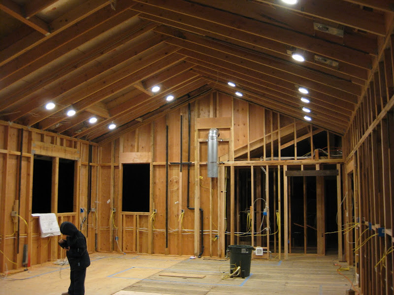

First pic full light, second dimmed:
Here are the lights dimmed. I mentioned the flickering thing and my contractor said he has definitely seen it before. The Cree ones that we used didn't have problems with that though and I felt they dimmed fairly well. I am not sure I'd ever really dim the kitchen this much. I tend to like things lighted!

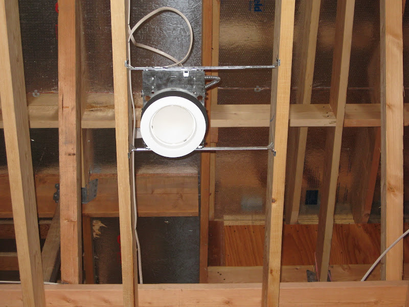

This is a fairly bad photo of the can, but it shows how the can is "flat" and bulbless. The "bulb" is behind the opaque lens. Also, the LR4s seemed too small for my space, so I opted for the larger cans, but if you want to be more discreet, the smaller ones are now out.
