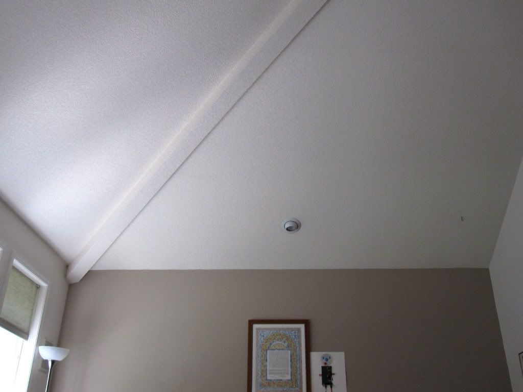

Please help me figure out the best way to light our family room. Its got a huge vaulted ceiling and the switch turns on a teeny-tiny light over the fireplace (we call it "The Eyeball"). All we've got is a torchiere (classy, huh?), but I would love something that looks like we're grown ups that actually own the house.
The wall on the left is all windows, but we live in Portland, Oregon and sunlight is hard to come by for about 7 months a year, so we really do need good ambient lighting.
Btw, the backside of the fireplace is the exterior of the house and the backside of the tv wall is the garage (which is why we have the tv mounted there - tons of cables are hidden away in the garage). Above the ceiling is the roof - how do we go about wiring anything in this space??
Ok, this is how desperate I am for help - I'm letting you see this awful undecorated room. I'm so grateful for any suggestions you have (decor, too!). :)
Here's an idea of the height...

I forgot to include the photo of the slope of the ceiling (this is just above the fireplace mantle (which is going to be stained dark walnut to match the adjoining kitchen, which is just about to begin a revamp).
thanks davidtay
can you tell me where you suggest placement and how many you suggest? thanks!

Cove lighting is indirect lighting from light strips mounted at the upper edge of the walls shining onto the ceiling. I would think having the cove lighting along the entire length of the outside, fireplace and opposite walls would do great. You typically hide the strips with crown molding.
If you use LED, the strips will be thinner than T8 tubes. Consequently, the crown molding can be less beefy.
I would get rid of the recessed light.
The last option would be to put in an array of recessed lights. I won't recommend that as it would involve a significant amount of work and the lighting effects will depend on the installed lights.
Wall grazing lighting could be used on the tallest wall - the one the flat panel TV is mounted on.

The main work for cove lighting is building the crown molding which is easier and much less messier than making holes in the ceiling (especially a sloped ceiling).
RE: Two story family room dilemma...
thanks for your suggestions. i love the idea of cove lighting. however, i'm trying to visualize crown molding along only the fireplace wall - the other walls have funky angles that won't look good with molding. hmmm...
