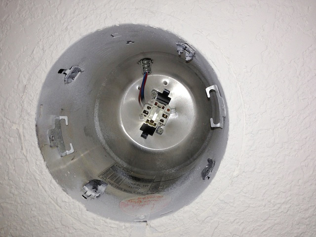

I took the reflector out of one of my CFL cans today, and I don't see an easy way to access the ballast, but I haven't disassembled one of these before, so maybe it's easier than it looks. Here's what I have:
Can you tell from that a way to get at the ballast (without cutting a hole in the ceiling -- I've already given our amazing drywall guy enough money in the last six months)?
Unfortunately these are in the kitchen on the first floor, with another floor above, so no access from the attic. That would just make it too easy :)

What size is that can? Can you read a make/model on the label?

What brand/model can is it? Even zooming in with gimp, I couldn't make it out.
There should be a way to 'service' the ballast. Looking at the photo, I'd guess it has to do with those four clips. Perhaps there is some pertinent documentation at the manufacturers web site?
RE: Truly dimmable LED recessed floods
It looks like a remodel can to me. The four clips hold the can in place. The ballast is probably up in the ceiling. To get to it the can has to be pulled out of the ceiling.
Get the manufacturer and make from the can first. The 4 clips need to be manipulated for the can to pop loose.

The manufacturer is Elite Lighting, and it's a 6" can. There's some paint in that one so I can't read the entire label, but it shows catalog number B6PLRIC-26-E. From some Googling, I believe this is it (though I'm not sure where the "26" comes in). So yes, it does appear to be a remodel can, which is good news. I knew it was added during a remodel (before we owned the house), but I thought they'd pulled down the ceiling, so I assumed it would be a new construction can.
So, perhaps not as bad as I thought. To make sure I understand, the idea is to pull out the can, remove the incoming line voltage from the ballast, and pigtail on a GU24 connector, feeding that back into the existing can, right? Or I imagine I could pull the balast and can out completely and put in a new can without a ballast, though that seems somewhat wasteful...

You need to disconnect the ballast as well.

I wouldn't recommend it. Even if it works for the moment, the high striking voltage from the ballast might take out that expensive LED bulb in short order.
There should be a way to drop the can so that the ballast can be serviced. Just need to figure out the trick. (And report back here, so the rest of us can learn.)
