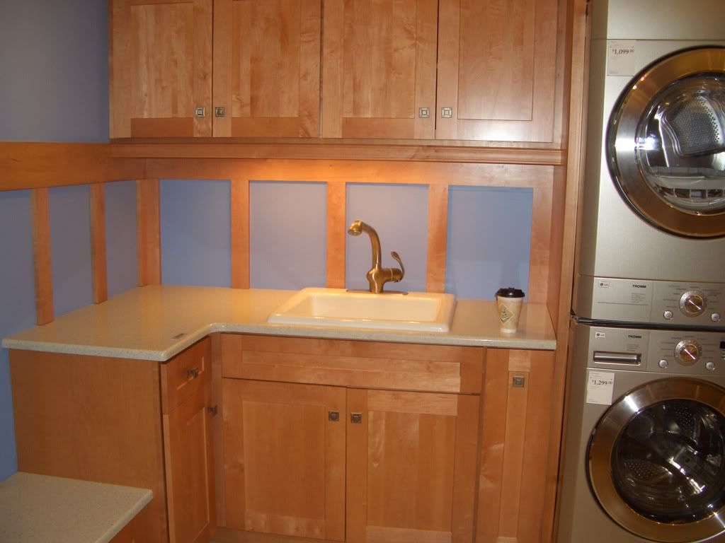

It depends on the design of your laundry room. I personally like the stacked. Putting a countertop at the height of your washer/dryer would not be a comfortable height conducive to folding clothes. LG has a nice stacked unit with the controls both in the middle.
Laundry Room Pic 1
