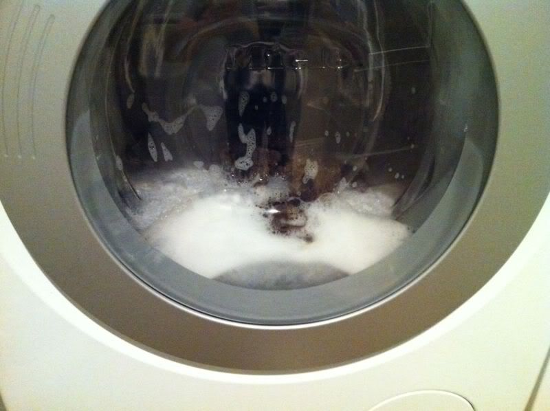

My beloved Green Works detergent has been sudsing lately like crazy. I've even tried reducing the amount by almost 50%. During the wash cycle, there are little bubbles, but nothing to be concerned about. But...it seems to not want to rinse away. I have been using Sensitive (3rd rinse) on my Miele W4842 with every load. It's worse with towels.
I think I have to give it away. It's been doing this now for weeks. Here is a pic during the SECOND rinse:

Your drum barely looks half full? How much are you using?
Weird, I have no issues at all. I usually use to line 1 for a half full drum. When closer to 3/4 full I add about 1.5.

PS. Your rinse level looks much higher than mine? I know my previous Frigidaire had higher water levels and I always had suds issues. Now with the Miele set to factory settings - no problems.
RE: Clorox Green Works sudsing like crazy!! :(
I have my W4842 set to Maximum Water level and water+/Extra Rinse. I think the tiny water rinse level (default) is insanely low. I love higher rinse levels.
The load in this picture, is hard to see...dark towels. In this load, with all the suds is 2 large bath towels, 2 hand towels, 8 wash cloths and 2-3 kitchen towels. So a nice sized load.
I've tried with load much larger and much smaller. Line 1 on the cap, Line 2, 1/2 of line 1....crazy sudsing with rinsing. So sad, since Green Works is almost my favourite detergent.

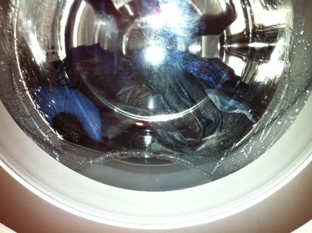

@ larsi
Here is what my laundry looks like during a 2nd rinse. This was after using one capful of Vaska and Vaska fabric softener...
Talk about airing our dirty laundry... LOL

@larsi,
At first topic glance I thought you were dying here, but your sudsing is minimal, and your Miele will intercede and enter into a special sudsing cycle should the suds become a problem. Your photograph exhibits suds that are nowhere near your machine even remotely entering that special cycle. I have had ours enter it once, and the screen readout tells what you've done. Have you cleaned your machine with Miele Descaler (100% citric acid) lately? Miele techs recommend doing this to also remove detergent buildup on those parts of the washer not visible to the eye.

@sshrivastava & larsi, all these pictures make me jealous about your water levels ;-) Even with Water Plus in my LG machine I never have water level reaching the glass on the door.....
Wow...Sstava. That is some seriously clear rinse water. I do not know if mine has ever been that clear...regardless if I use Tide he, Persil, Vaska and especially not with Green Works.

New picture
Doing a load now, using Tide liquid HE. This is a large load...2 pairs of jeans, maybe 6 or 7 t-shirts, one button down flannel shirt 4-5 pairs of underwear and 2-3 pairs of socks. The dosage was to the Maximum, Line 3 on the cap of Tide HE.
This is during the 2nd Rinse after washing with Tide HE, before the 3rd Rinse (Sensitive Option) and Fabric Softener will be dispensed. Huge difference, compared to Green Works (see 1st picture).

That still doesn't look like a large load to me? The drum is maybe half full?

My friend, that is not a full load! Compare your photo to mine and see how much more laundry I have in my drum. That is a full load! Yours would rate as a medium load in my house, for which I would use only halfway up to line 1 on my Tide HE cap. With your harder water I would probably say go all the way up to line 1, maybe a little higher, but certainly not line 2 or line 3. I think you may be using too much detergent.

I have to agree with sshrivastava. The loads you are describing and showing in the pictures would count as small to medium in my book. I would not use more than 2/3 to the first from the bottom line of Green Works for that size load. To me a full load in my machine is a load that will fill the drum loosely when dry and will compact to half to 2/3 of the drum when wet.
If you have been overdosing on detergent for a while, the sudsing you are seeing now may be the result of detergent build up.
