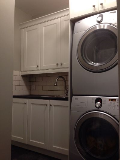

Did anyone stack their Front Loaders to save space? Do you like it, or have regrets? What is on the bottom? Do you have any movement of your washer? How does it stand up against the vibrations of the washer cycle? Do you need to buy special ones to stack?
I have side by side front loaders with peds,so am familiar with the vibrations and movement.

Washer is always on the bottom. Only units with controls on the front can be stacked ... there were/are some models with control panels on the back like a toploader but probably aren't as common nowadays. Stacking typically requires an adapter kit to anchor the dryer to the washer ... it doesn't just sit "freely" on top.
Stacking can be difficult to wrestle the water/plumbing and dryer vent connections if the units are installed in a closet or cubby-hole. The washer's water faucets, both power cords, and gas if applicable to the dryer MUST be accessible to shut off in case of an emergency. Service is also a challenge, being as the dryer pretty much always has to be take off the washer to service either one. For those reasons, I would personally never do a stack set.

I have a stacked set upstairs and a side by side set down stairs, all Askos. The stacked set has much less vibration/noise due to the weight of the dryer.
