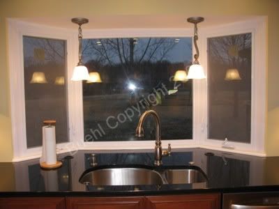

    I have the S405D and think it's the best use of a 36" sink base. Because of the bowl sizes, it gives me the functionality of a double as well as a single.
    Dimensions:
    Overall (exterior): 35-1/8" x 20-7/8"
    Interior of Large Bowl: 21-3/8" x 18-3/4" x 9"
    Interior of Small Bowl: 10-1/2" x 15-7/8" x 7"
    The large bowl is wide enough (21-1/2") to fit my longest cookie sheet, all my pots & pans (including handles), all my refrigerator bins & shelves (except the 30"+ wide deli/meat tray), and a variety of items all at once.
    The small bowl is large enough to fit my 8qt stock pot and all my colanders, but small enough to use to soak utensils or fill for small hand-washing jobs, if needed, w/o having to fill a full-size sink.

    Discussing brushed v shiny with the GalaxyGuys...the brushed is the same finish that the bowl of the sink has. Which in my mind, will be easier to maintain and this was seconded by the GalaxyGuys.
    They stated that some people like the shiny rim especially if the sink is mounted with a positive reveal - this is where the granite is cut slightly larger than the sink so a little bit of the sink rim shows.
    I plan for a zero-reveal (no rim showing, granite edge is flush with the sink bowl)....but no over-hang by the granite (which would be a negative reveal).
    Looking at Buehl's pics....I think she has a zero-reveal install for her sink.

    Definitely get the brushed rim. They didn't have that option when I ordered my sink in January 2008.
    My sink was supposed to have a positive reveal, but I ended up with a mix of all three...negative in some places, zero in others, and positive in yet others. The fabricators couldn't seem to cut the sink cutout correctly to give me a consistent reveal. (One of the many issues I had with their fabrication and installation...but this was minor compared with the rest!)

    Buehl,
    Do you have a pic showing how your sink is centered in your window? Since the faucet gets mounted around the curve between the large and small bowl, is the sink itself centered or the faucet?
  • Buehl
    13 years ago
    The sink is centered on the window.

    Buehl, what kind of faucet and finish do you have? I like it a lot.
  • cigi_2010
    13 years ago
    It looks like a kohler Vinnata. What finish? Have you ever had any problems with it? Would you recommend it? I think I remember that the Vinnata is about 10 inches high. That seems like a good height without being too overpowering. Some faucets are just so big.
