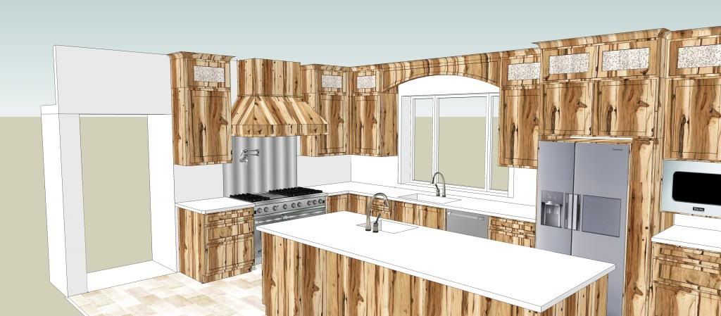

I am getting all the specs for our cabinets ready, and am now thinking that it might be better to do 4x large cabinets (outside boxes are 24.5", so cabinet doors would be ~22" ?), instead of 8x small doors. What do you guys think? They would be similar in size to the cabinets above the refrigerator and microwave. Ceilings are 9'2", so the uppers will be fake-stacked 38" and 14"

Less doors, looks less busy. Depends on what you like. Personally, I am going with the less door look. Have designed my kitchen with this in mind.

Personally, I am going with the double doors because only have two uppers flanked by 18" cabs on each end I only have 8 foot ceilings and It seems that the linear look kinda makes the ceilings look taller....but I recently saw a display that had eight or ten cabs with all 24" doors with the stacked cabs on top, and the display was impressive. I loved the look.

From a functionality standpoint, it depends primarily on where you want to be standing when you use them. For example, if it's over your dishwasher, then a single door would be best because you'll be on the side when you use it.

If you will be going with a rustic (hickory?) wood like your pic shows, I would absolutely simplify. And try to simplify even more. It's a very busy wood and the design is contributing to the visual overload.

As an owner of 24" wide uppers, I can say that functionally, they are a bit of a challenge.
Plus: One move opens the whole space.
Minus: You might just loose your nose or at least get a good conk on the head opening the door. Or, whack the person that is standing nearby. The door swings out past the counter depth so you have to step back as you open it. It's awkward.
If you can handle the look of the narrower doors, I'd recommend those from a functional standpoint.

I should have said our countertops will be 30" deep w/ 15" uppers- so if the cabinet doors end up being 22", they will stick out over the countertop 7" when fully open. That could be a pain. It sounds like it has been an issue for some of you...
