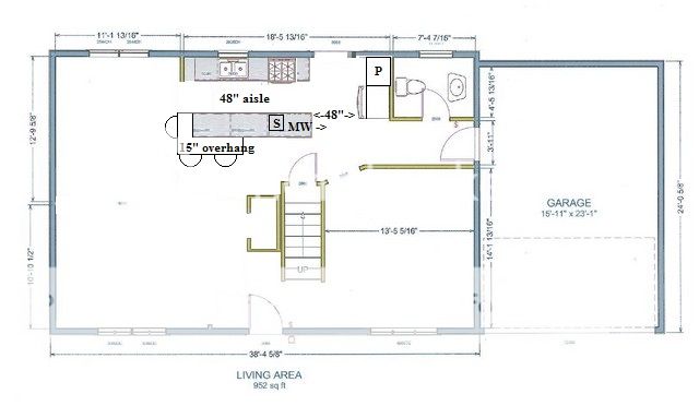

Hi dazraf, here is a very rough sketch of what I was thinking. As I was doing it I thought it would be great for you to have a pantry, so I put it next to the fridge (denoted by the "P") and put a drawer MW in the island ("MW") which pulls out towards the fridge. "S" is the prep sink.

Thanks tracie, I like the look you presented and will be considering it.
