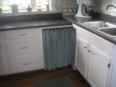

  • AdminG1
    Here's my corner cabinet. I love it! My kitchen is extremely small and I almost lost this space which would have meant even less cabinet space for me. Yes I still have to get on my knees for the bottom shelf but I just make sure I put items that I don't use on the bottom.
  • AdminG1
    Here it is open.
  • eric smith
