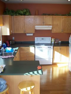

This is a picture of the kitchen in our old house. Picture was taken during remodel in 2001 before backsplash and brick were installed, so it's probably outdated according to GW standards. We had 9' ceilings, 15" between counter and uppers (I'm 5') and the uppers were 56". They were custom cabinets, so the uppers were one piece. I am of the same opinion as you. I did not want a space above the cabinets. Daughter has that, and although it looks nice, what a pain to keep clean. She has "stuff" up there, and I find it distracting. On the same scale as borders on the soffit.
The kitchen in our new house is so much bigger, and we chose not to do to the ceiling, but did a soffit (gasp!!), and are installing a heavy bracketed crown.
