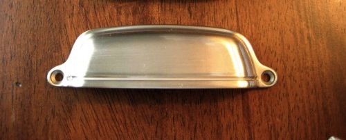

My Restoration Hardware pull has the screw at the bottom. I may be off but I was thinking if the holes were always done in the center of the drawer that most of the pull would be above center... Or do you think that's too high?
BinPullsTop-500x375, Pottery barn (top) RH (bottom)
