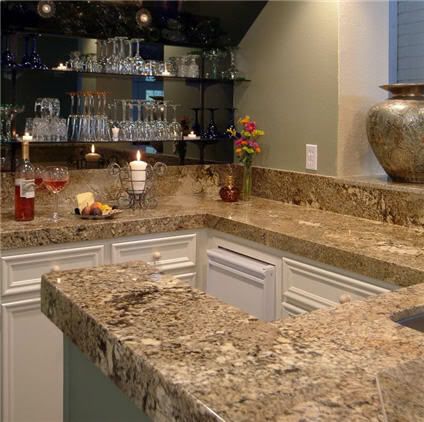

I too am in So. CA and had 2 cm granite with a mitered edge. I also had a cooktop that had to be built up so it would fit over the oven. I have a 2.5 inch edge and I think it looks pretty cool. Lots of compliments! When I was in the fabrication stage I too was unsure so I googled for that size edge and found tons of pictures.
Here's one:
