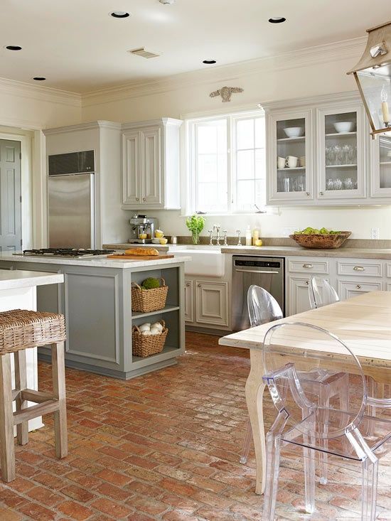

Is it harder to stand on than tile?
I didn't even go looking for this photo...it just popped in to my pinterest feed this am, so I had to share.
Here is a link that might be useful: Here's the source of the photo
RE: Does anyone have a real brick floor in their kitchen?
Not sure why brick would be harder to stand on then tile. The floor you posted bee is really really nice.
