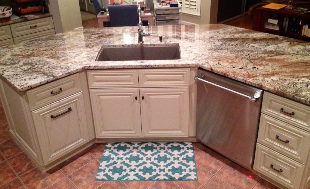

  • kgolby
    Annalyn123,
    He used a glue similar to super glue to attach the broken piece back. He said it's around 100x's stronger than super glue. Not sure what the other material is called that he used to fill in the gaps. It came in a variety of colors which he used to disguise where the crack was. He matched the colors of the granite perfectly.
    I took a pic of my island so y'all could see my granite. It's 2 bookend slabs that match in the middle where the sink is. The broken corner was on the left end right above where the trash can pullout is. I was heartbroken last Friday thinking we'd have to replace the stone. Just so relieved it was a happy resolution.
    Don't look too closely behind my island. It's really messy....hahaha!!
