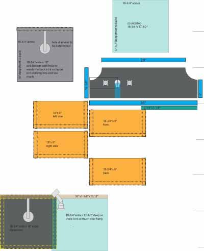

| I have finally gotten to the point where I need to get this sink built! Some of you may know that I have been planning this build for months for my bathroom/mudroom, next to my kitchen. I have these remnants that I got for a song. It will be a farm type sink with a tall backsplash.
So I'm drawing patterns and devising plans to cut some soapstone soon (tomorrow?)
Here is my sink front:
It looks like a dream with my llistello and paint sample. My computer makes the elements have a lavender cast, it could be the time of day. The colors are blue, gray, tans, and ever so slight bluegreen. The picture doesn't do it justice. In real life it's like a hazy dream, perfect for a bathroom don't you think?
I'm keeping my fingers crossed that it all turns out!!! Thanks for looking and keep me in your prayers:)

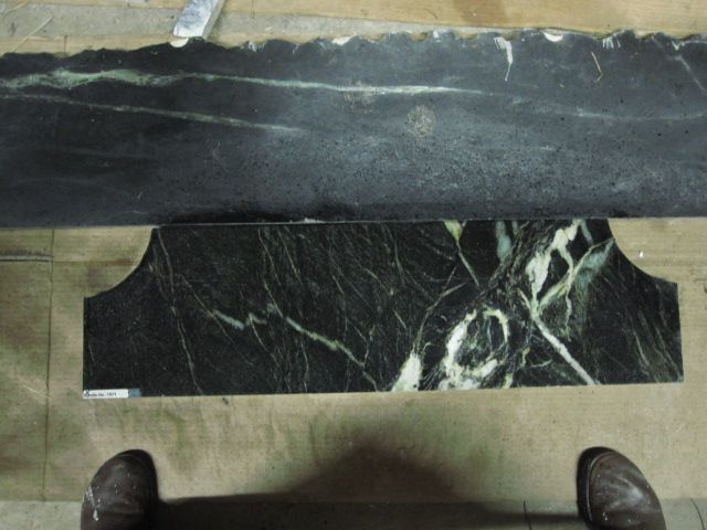

| Got all the parts cut out. Working and getting home after nightfall is a drag. I can't get up the ambition to get to the shop to work on this project tonight. I am a morning person! Here is were I stand, with the cutting of the stone. I used the very good 5/8" bit the guy at the Woodsmith Store sold me. It cut and cut, even with the strain of harder stone inclusions. I took 3 passes on each rabbet or dado cut. pattern to cut the backsplash:
more patterns:
cut pieces with rabbets and dados:
Backsplash, unoiled:
wd40 used to oil stone, to get "an impression". Isn't that icy blue dreamy?
