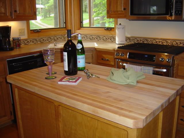

    This is the maple island counter in our slowly progressing kitchen.
    It has seen hard use since the beginning of April. We love it!
    I have oiled it with mineral oil only.
    Tung oil would give a more lustrous, more gold finish.
