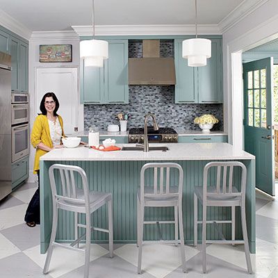

    I have a pulls that are similar in style to the ones you are using. My doors are not slab but if they were I think I still would have put the pulls in the same location. The bottom edge of my upper door pulls is 2" from the bottom edge of the cabinet door. (on my base doors the top edge of the pull is 2" from the top edge of the cabinet door. Here is a visual of the uppers for you:
    Since I personally don't care for the look of pulls in the middle of the drawer, I had my pulls mounted near the top on both the slab drawers and five piece drawers. The pulls are one inch fro the top edge of the drawers.
    Here's how that configuration looks:
    If you do a google search with the terms gardenweb and pull placement you should be able to find lots of previous posts with pictures and opinions.
    As you will see there is no rule. All you need to do is decide the look you like.
