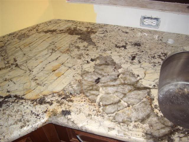

    Granite is a pretty fragile material until it is installed (I assume C-stone is probably the same) which is why many fabricators prefer to seam it at the sinks. Since the sink cut-out leaves only a few inches of granite at the front and back of the sinks, this is a really weak spot unless it is seamed there. Some fabricators will put the seams elsewhere and use plywood and C-clamps at the sink cutouts and have no seams the sinks. Personally, I am thrilled that my fabricator seamed at the sink. Instead of a 25" long seam, I have two small seams that are barely noticeable. And the one corner that I do have is unbroken by a seam.

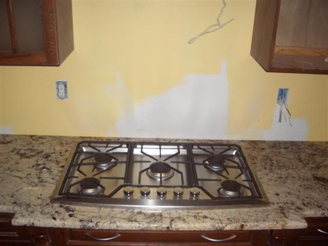

    In my picture, there is no seam. That's the beauty of seaming at the center of the sink. Here's one of my seams....at my cooktop. With a pattern as busy as this one, it would be impossible to make an invisible long seam, Seaming at the center of sinks and cooktop makes the seams much shorter and less noticeable.
