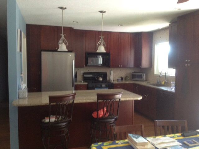

Here are my island pendants:
creamcabs
I was adamant about having down-lights so that they'd be effective task lighting. But the higher wattage, clear bulbs were too glaring for my eyes, so I replaced them with lower wattage frosted, and now they don't light as well. Also, the spacing was dictated by the coffers in the ceiling, not the island, so there's a large dead space right where I prep. My kitchen has lots of other lighting (natural and warm LED), so it's all good. But I thought I'd post this as a cautionary tale on spacing and balancing lumens and glare.

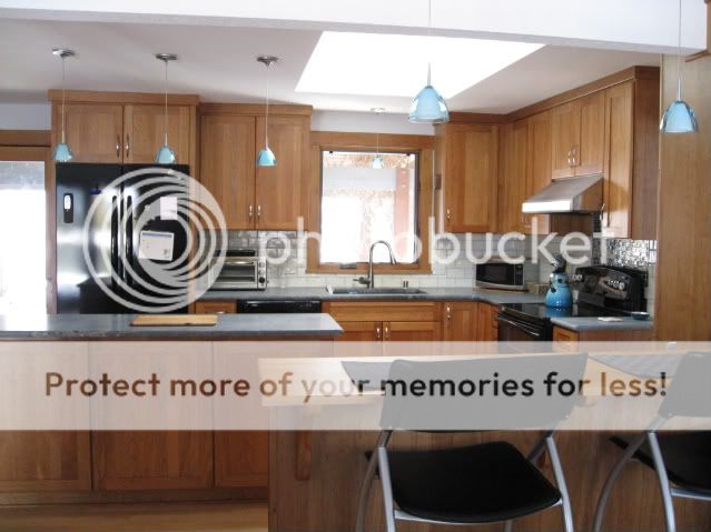

Just a different point of view-we knew we wanted pendants, and we wanted a lot of specific task lighting too. We get a lot of natural light from the skylight, but also went with UCL and pendants. Lighting is hard, and we went through several iterations before getting what we really wanted, both aesthetically and functionally. The pendants sort of fade into the background as well:

leela--where did you get your pendants? I really like how they are simple and blend in.

cathy-They are from Bruck lighting and are the Rainbow II down pendants in turquoise. We got them through a local store; their prices were better than anything we could find online.
