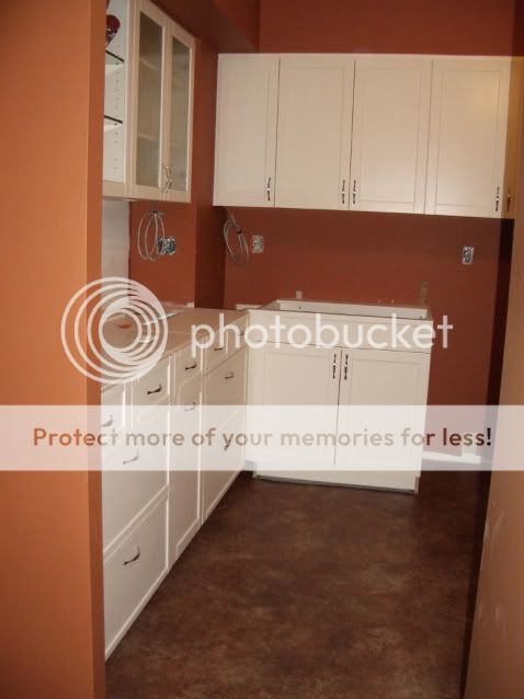

    Well, my uppers (pictured above) were designed with symmetry, the hood, the microwave, the spice pull-outs all in mind, so ... that's what really determined our uppers' widths. My widest upper is atop our 30" (wall) oven, so that's not a true comparison for you because if it were to fall it'd just rest on the oven cabinet anyway!
    I don't know enough about cabinets and building them to give you any useful information, other than my real-life example(s). Sorry!
