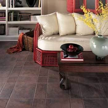

I agree diagonal would be good or maybe you could break it up, something like this pattern.

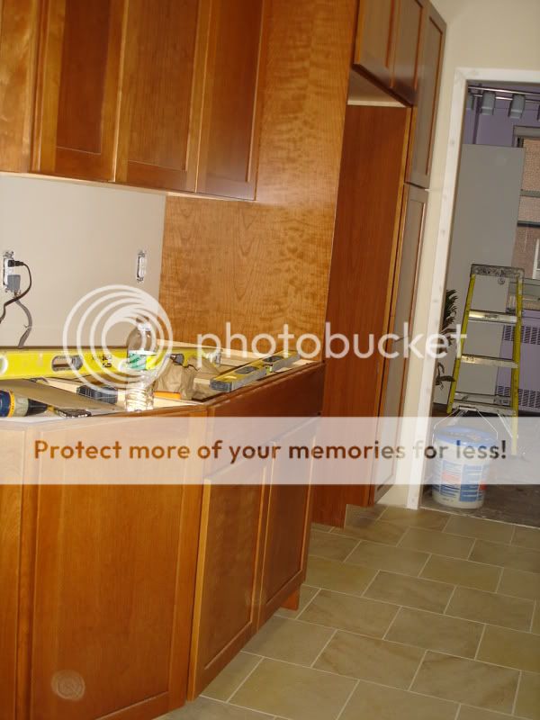

Floor came out great. I figured i should post the after since you all helped me with the before. (by the way, that is only a temporary cabinet and sink)
floor without grout
Hard to see in this one
temporary kitchen #2
other side
Fridge wall

That looks great!

Your floor turned out great! Tell me about your tile...I like it!

Thanks! tile is crossville palais style in the versailles color (porcelean tile) (12x12) It comes across more orangey in the pictures. There are like 4 different color variations but it is a tan/sand based tile with brown flecks and swirls and some grey too. I love it and it wasnt too expensive.
