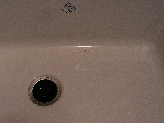

Here is a photo of my crazed shaws sink. The cracks are hard to photograph so its a little hard to see them. Marcolo, I still say its crazed. Mine started cracking around the disposal the day it was installed. The weight from the disposal was enough to destabilize it and start the cracking. It was not overtightening as many think. The cracks spread throughout the entire bottom of the sink. After a month there was a crack was present in every square inch of the bottom. Rohl was quick to agree it was defective and offer replacement once I told them it was crazed and it was a glaze defect and sent pictures. It should at least fall within their 10yr stain warranty as all of those cracks stain quickly. The problem is known to them (if you talk to the right person) and supposedly only affected some 'small' fraction of sinks made in 2008 according to Rohl. I don't think its still a problem in shaws sinks as it was a due to a bad batch of materials. Drainage problems still seem to exist with Shaws sinks since they have a flat bottom with little slope to the drain. But thats another matter that may or may not bother you. If you get one test its slope by putting a 2' straight edge across the bottom of the sink to make sure it is pitched towards the drain. Test it immediately when you get it and send it back if it is pitched away from the drain.

No. I said no before. Your problem may have been crazing. The other problems discussed here were cracked sinks. You weren't even part of those discussions, so you don't know what you are talking about.
